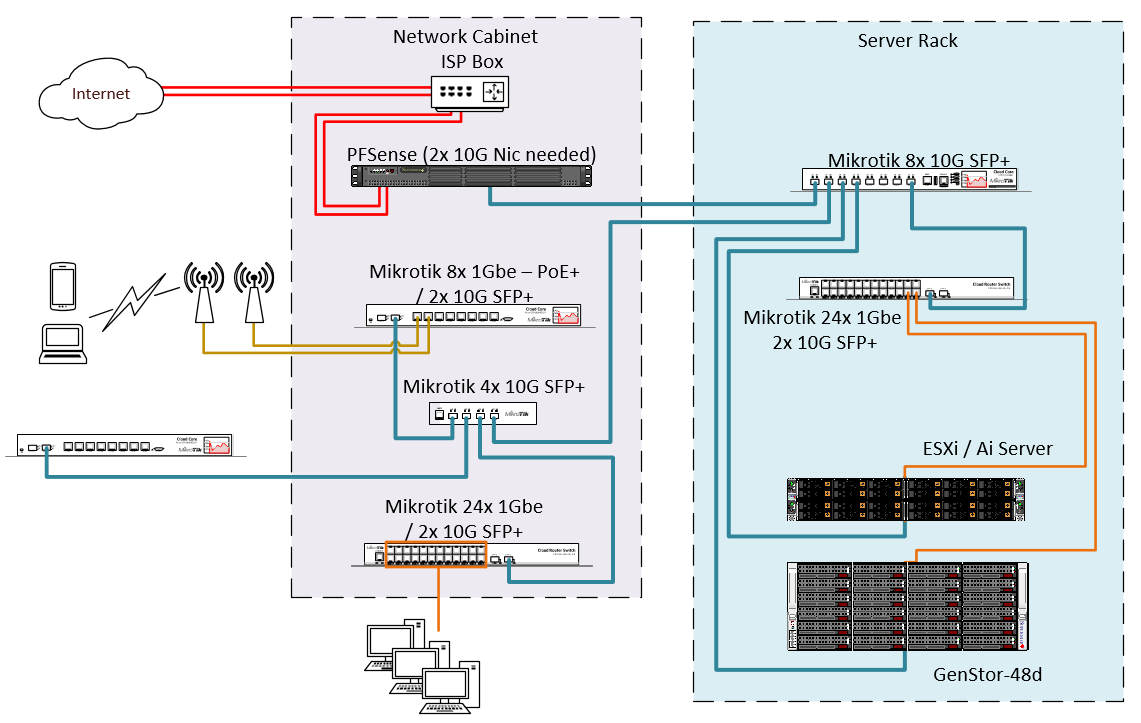

Connectivity diagrams for clarity.
Old setup
New Setup
I should also note that I have a GLNet WiFi router connected to the PoE switch and it has continued to work find both before and after the switch change. My Aqara G4 WiFi doorbell refused to connect to the NanoHDs (a while ago) and so I put this little travel router in as another stopgap. I hope the new WAPs will remove its need.
I will at a later date setup 3 subnets (WiFi / Server / Home) from the PFSense router via its 3x 10G nics but I need to get the current setup working with new WAPs first.

The issue with the NanoHDs seems to be with their DHCP clients. After putting the 4x 10G switch in the path between the WAPs and the Router (Gateway / DNS / DHCP) they fail to get DHCP provided IP addresses for themselves or any WiFi clients. They both revert to an IP of 192.168.1.20 which clashes with my printer. After unplugging the printer and one WAP, the remaining WAP is adoptable in Unify and although it’s IP address is set as DHCP, it will not set itself to the IP registered for it in the router. Setting a static IP on the WAP (inc netmask, DNS, & Gateway) results in the WAP not requesting IP addresses for WiFi connected clients.
The WAP is connected to a MT PoE switch which is then connected to the 4x 10G switch. Monitoring DHCP requests on the 4x 10G switch results in no traffic when a WiFi client connects to the WAP.
Going back to the old connectivity does not resolve the issue and my GL Net WiFi router connected to the same PoE switch has had no issues.

Have reset the 4x 10G switch to factory defaults and checked the bridge. All looks good and in line with the 8x 10G switch the WAP PoE switch was originally directly connected to.
I have also taken off the ‘Detect rouge DHCP’ to see if that would make a difference.
Still no good.

Initially the WAPs would not be adopted after the 4x 10G switch was added to the network. After discovering the WAPs defaulted to .20 and that the printer was on .20 I changed the static mapping for the printer and only connected each WAP one at a time to adopt and then set static mapping on them. Both WAPs then had individual IPs statically set without any duplicate IPs on the network.
The issue persisted. No DHCP was possible from the PFSense router. Only the Unifi WAPS were affected. The GLNet WIFI router connected via the same PoE switch had no issues.
The WAPs worked fine when the PoE switch was connected to my 8x 10G switch (also in RouterOS mode). The RouterOS config was checked between the 4x 10G and the 8x 10G switches and both seem to be in line with each other. Connecting back to the 8x 10G switch (removing the 4x 10G switch from the network chain) did not resolve the issue.
The 4x 10G switch has been factory reset to make sure it was not an open box unit and had something unexpected previously configured but still no change.
Connecting the new Mikrotik cAP-AX WAPs to the same PoE switch results in them being able to obtain IP addresses without issue. Getting WiFiWave2 setup on one of my RouterOS switches (RouterOS 6…) seems to be more of a challenge but I will start a new thread on that so any information can be more easily found for others who have an interest.
The problem seems to be with the NanoHD WAPs and not the network setup.
