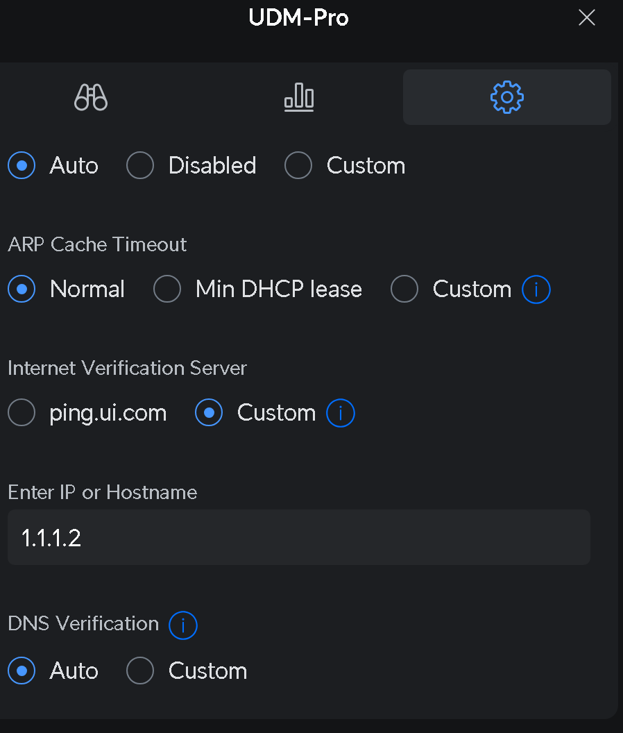

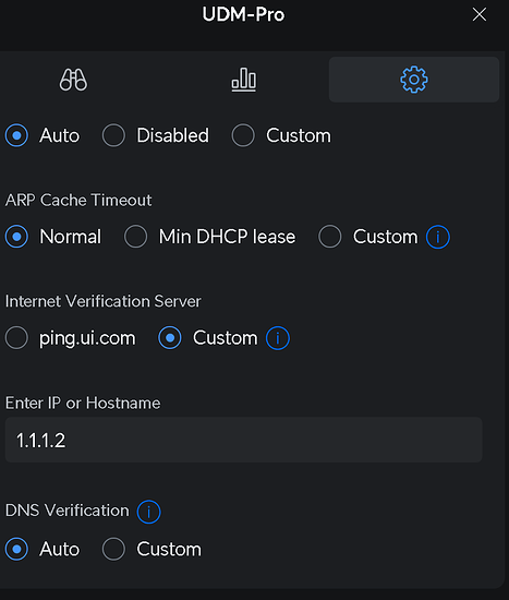

Try changing the verification server. Should be in the Dream Machine Pro SE settings. I know the default ping . ui . com has issues. I am using 1.1.1.2 but you can use whatever you want. Not sure if it is directly tied to the speed test server or not. But i noticed a speed increase by changing it. I believe by default ping . ui . com points to 1.1.1.1 or 8.8.8.8 depending on your location.
