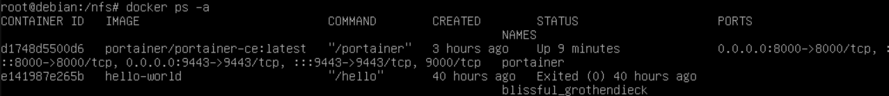

I have managed to get through the majority of setting up portainer, but I am struggling with the very last steps. As you can see below, I have managed to set up docker engine and I’ve also managed to get portainer running, however I don’t seem to be able to navigate to the GUI in my browser to actually use it!
The ip should be 192.168.1.2:9443, but after digging around it looks like portainer might be trying to use 0.0.0.0, is this normal? I have read this may be normal, but hopefully someone can clarify this for me.
