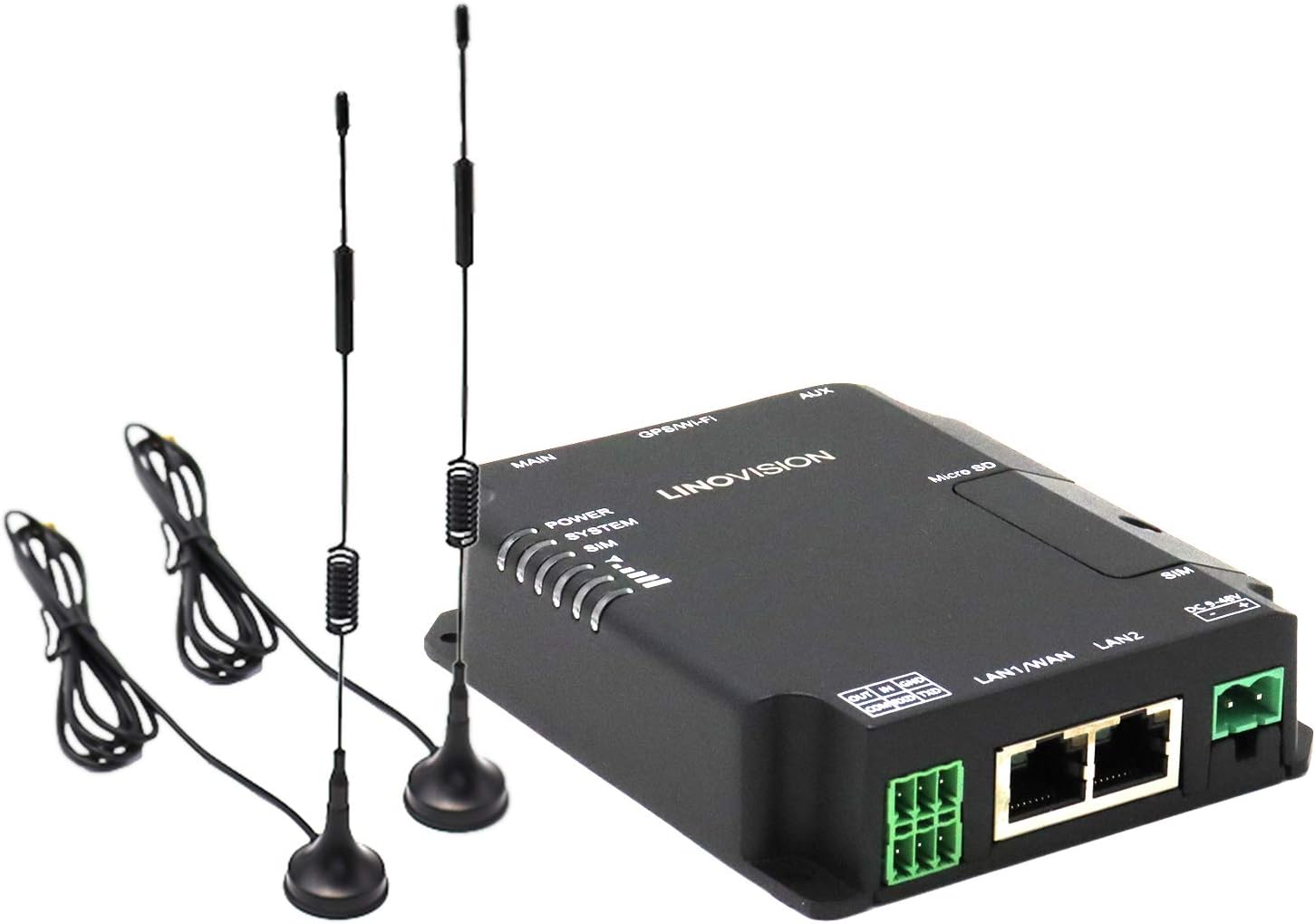

I was thinking of something like this:
But idk if you can reflash it to something like PFSense or if the factory firmware supports bridging WiFi to the local LAN.

I just found this which seems like it supports aggregating and load balancing + WiFi WAN
I think we are going to move forward on trying this solution:
