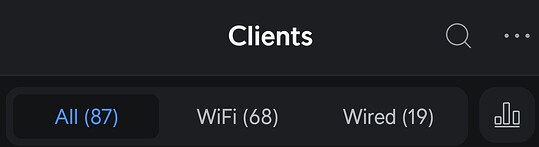

Have you used Unifi for a firewall? I know they’ve come a long way from back in 2018/19 when just the firmware upgrades were a bit rough. Right now everyone is gone, and work machines are off. And I still have more clients than I would have thought.
I would assume unifi could handle a measly 100-120 clients spread over 4 APs, plus routing.
Yep, to mixed success, but as recently as this year. Started with a USG, tried the new Gateway Lite and found it no better performing than the USG (one of my gripes), and the Gateway Max (seemed fine, and yay for 2.5 gbe ports). The rest of my gripes were around missing features, or the new ‘easy mode’ firewall rules and DNS adblock sinkholing being opaque about what it’s actually doing under the hood, so I’m still evaluating my options there. My environment is quieter than your count of wired clients, though, and it’s a 3:1 ratio of wired:wireless clients, so that’s going to be a confounding factor for comparison.
