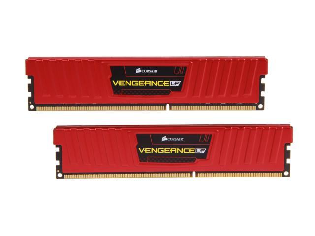

Why not just use the USE as a boot disk and then just run everything from a RAM Disk? if you are not using DDR4, RAM is cheap and will be leaps and bounds faster than USB RAID.
You would setup the RAM Disk to periodically Sync with the USB drive. Just pray for no brown outs or black outs. Unless you have a UPS.
https://www.newegg.com/Product/Product.aspx?Item=N82E16820233304&cm_re=ddr3--20-233-304--Product
Ram prices suck dawg. Ram, and GPUs really just aren’t something you should buy right now unless you have to have it.
