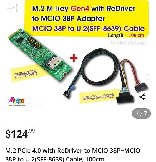

U.3 compatibility with a U.2 adapter cable and redriver
Check this out on @Newegg:M.2 PCIe 4.0 with ReDriver to MCIO 38P+MCIO 38P to U.2(SFF-8639) Cable, 100cm https://www.newegg.com/p/0Y3-00M7-00635?Item=9SIAA6WK0S4518&Source=socialshare&cm_mmc=snc-social-_-sr-_-9SIAA6WK0S4518-_-10282024
Got it, & it works

I purchased the same cable.
Got the serial number from video.
Wrong cable. WTF Dr. Stranglove.
