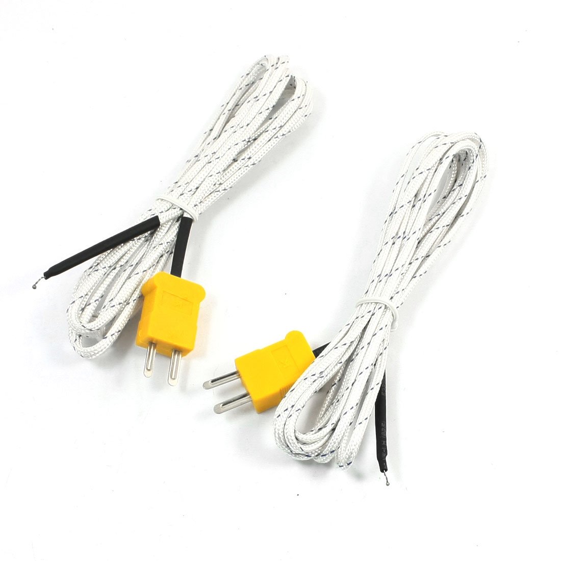

And the sensor (thermocouple):
Holy cow, thanks for the advice! That's a bit (err a lot) over my head, but that's a very interesting idea. I've been telling myself for years that I need to get into stuff like this (bread boards, etc), so maybe this is the excuse I need to take the plunge. Thanks much!
