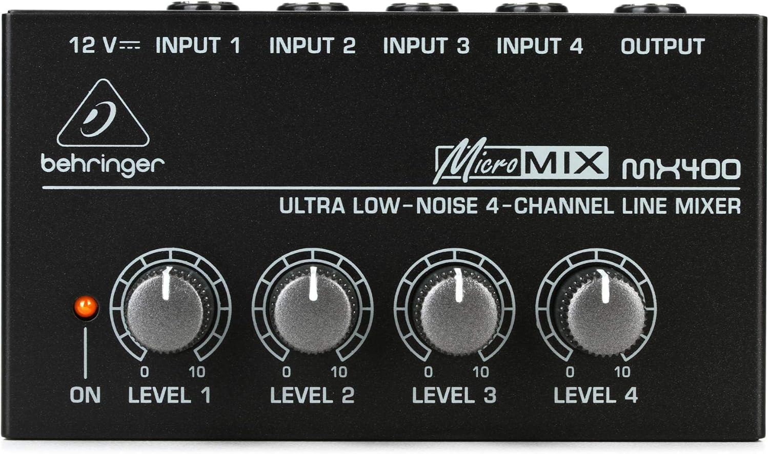

I understand using a mixer to mix the sound but that is a lot of trouble and effort for a single, simple sound feed. I am using an O2 AMP/DAC for my gaming system sound. Is there a simple way to integrate the two sound outputs, or a simple sound mixer that is reasonably priced and compact?
I have this one, it works pretty well, especially for the price ;)

Thanks for the replies, my concern with the NX400 is it appears to be a mono device and I want to use this for gaming.
Oh dang I didn't even notice, I might have a different one then because mine is stereo as far as I know... I'd need to dig that up again then because I haven't been using it for a while. Sorry about that :( Maybe Amazon suggests some nice alternatives that are stereo ;)

Now if you want to DIY this, you are going to need a passive summing circuit. Rane has a very good article on this here. I ended up designing my own PCB for my DIY bluetooth speaker, which only cost me a bit of time and not too much for your components. I could probably build a few mixers like @UncleGamer wants for less than the price of one of those MX400's I linked earlier. Hope that cleared something up :)
