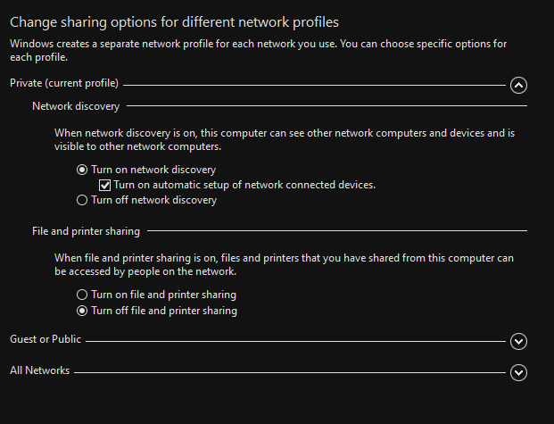

Have you checked the network settings? To make sure that the PC is set to be discoverable on the network.
Network

I appreciate your suggestion, Grog. Although I don’t see how it would be relevant, I tried to turn it on. Unfortunately it didn’t cause any noticeable difference. Still no Internet access.
