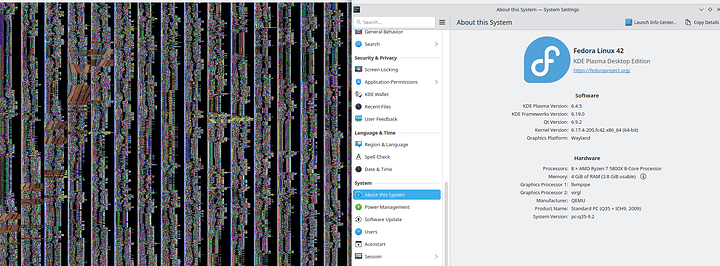

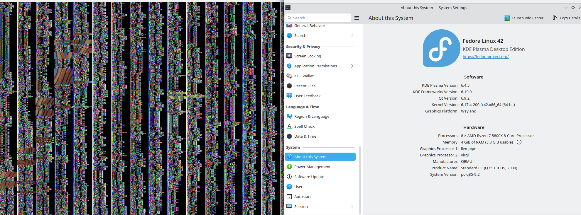

You tested with both SDL and GTK displays? You can also try to run -display spice-app,gl=on with vga=qxl - Just make sure your parameter -name "OS" contains no spaces.
It works with a pretty loose definition of works. See those two lines of “graphics processor” - 2 being virgl that is jumbled, 1 being llvmpipe (vga=qxl) that displays a picture but its not 3d accelerated.
Sadly no, you cannot run VirGL + Spice display with qemu. I’d wager this jumbled mess is not limited to Intel graphics. Maybe we could have a confirmation from someone running nvidia/amd (:question: marks in the chat :question: )
