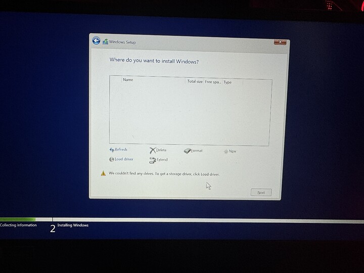

Trying to install Windows after having POP!OS installed, Windows doesnt see the other drives
Hey all,
I finally made the jump into Linux and have installed POP!OS on my laptops Samsung 4TB SSD.
I also have 2 other m.2 Samsung 2TB ssd’s installed in the laptop.
I formatted both the m.2 drives and changed file systems to NTFS as I was not able to see the drives when trying to install windows as secondary OS.
I have looked into a bunch of different things and keep thinking that its either something to do with the filesystem or yeah I don’t know I’m at a bit of a loss right now.
Have tried a few things but none seem to work to get the windows boot loader to see the disk drives.
Any help would be awesome

Can you see the drives in the Windows Disk Manager utility, or in the device manager?
Then it should be simpel. You should be able to boot from the 4tb drive. Windows bootloader is not going to dual boot Grub is
the drives don’t show up at all in windows but they show up in BIOS I cant even see them in CMD when i’m trying to find them that way hoping I can do something with it.
I don’t have windows installed on this system, I am currently trying to install windows on this system on a separate drive to Linux but that drive is not showing up whilst trying to install windows

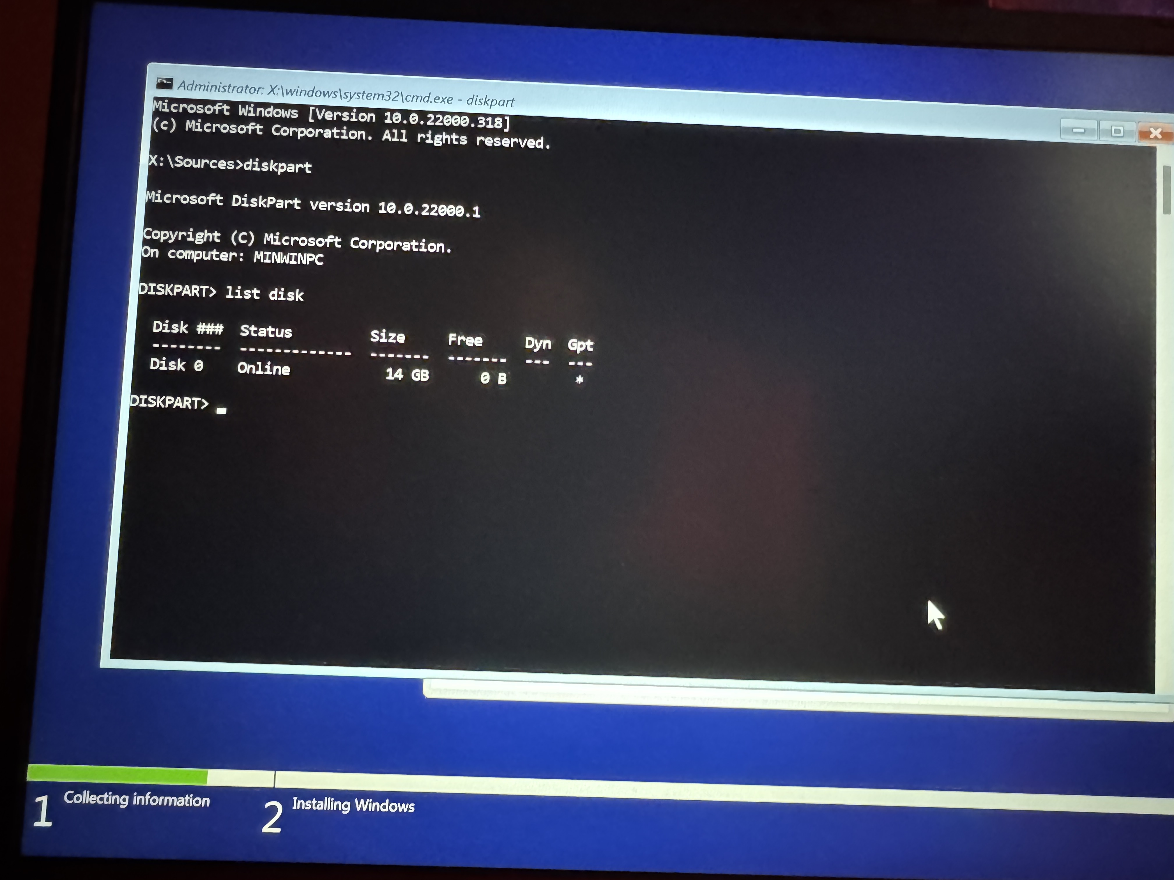

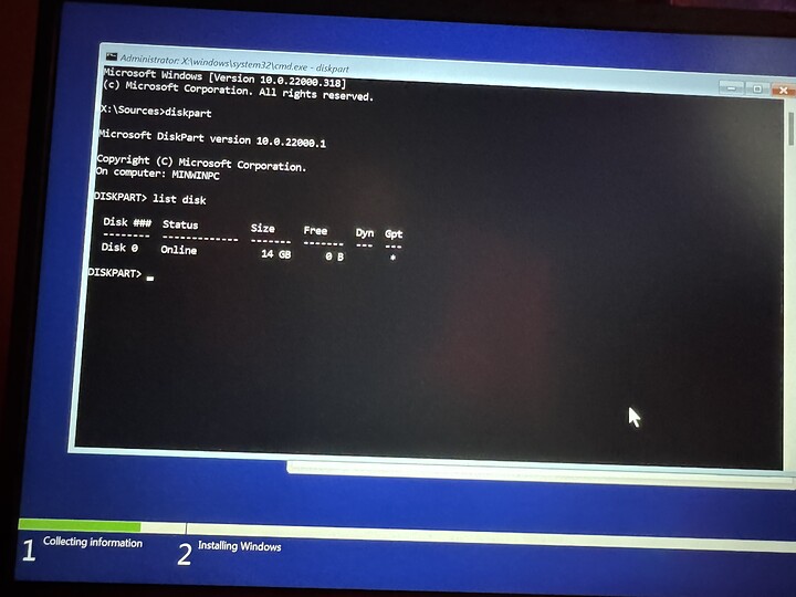

from windows install this is also posible
  1. From inside Windows Setup, press Shift+F10 to open a command prompt window.
  2. Type diskpart and enter.
    3…Type list disk .(look for your disk number, check the size of the disk)
  3. Type select disk . example: select disk0 (select the disk you want to format)
  4. Type clean.
  5. Type convert gpt.
  6. Close the command prompt window.
  7. Continue the Windows Setup installation.
If you are not sure. Post pictures of where you are
Other posibility, And i’ve didn’t see that in ages. Windows install might not have your sata / raid drivers. Download them extract them and put them on usb. You can then add them with the load driver option
