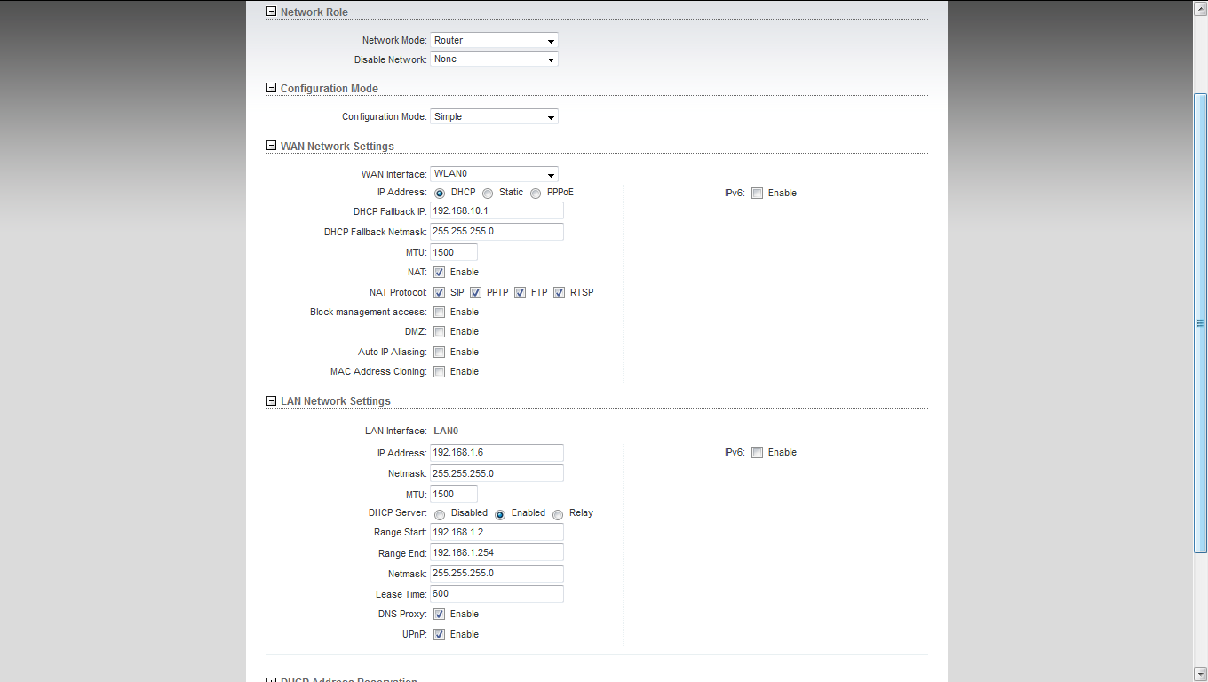

On the litebeam side I tried disabling DHCP, on the belkin side I tried setting a static IP and using a dynamic connection with no luck. here is a screenshot of the litebeam configuation

From the screen shot, you have the LiteBeam configured as a router, I’m betting that you don’t want this. Change that too either extender or Access Point. That could be why you can’t connect to it when its connected to your network.
Its getting a IP but its getting on on the WAN not the LAN meaning when you try to get the web interface through the WAN its like LOL no and drop the request.

If I change the litebeams setting off of router I cannot communicate with the AP properly. The only other option is bridge and that mode will not work with the AP. note: I am on the latest firmware.
I went ahead and double checked if I change setting in the litebeam from router to bridge I am unable to connect to the internet, both plugged into the router or into a computer.
there is also a setting called soho router but in that mode I cant get it to do anything and I end up having to reset to defaults to regain access to the settings.

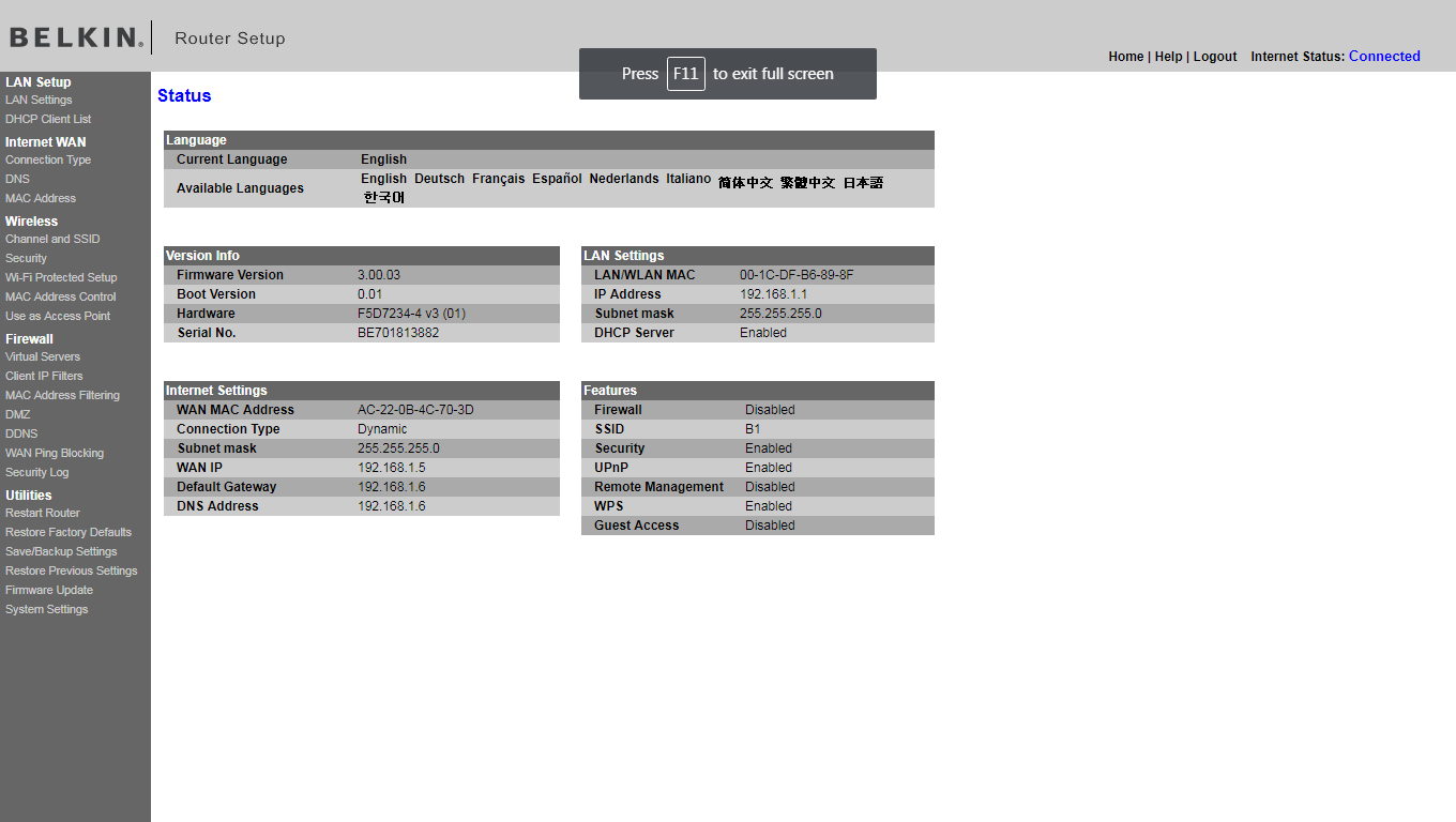

on the belkin, your wan ip subnet conflicts with your lan ip subnet (they’re both 192.168.1.0/24)
leave the wan settings, and change the lan settings on the belkin and make it have 192.168.2.1/255.255.255.0 (which would make the subnet 192.168.2.0/24).
Oh shit your right. I forgot I changed it to that because I have been setting up a lot of these antennas lately and for initial access to settings your host system must be on the 192.168.1.x subnet.
