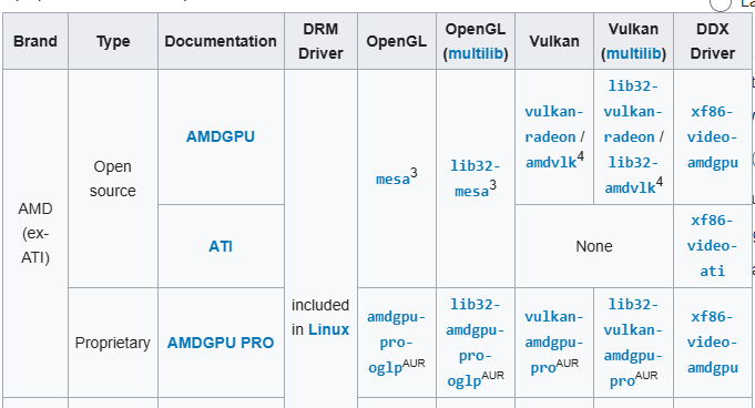

Meanwhile there are 3 “competing” runtimes for AMD GPUs within the ecosystem:
source
source
Actually, no. If you look at that image you have posted, there are only two implementations within the Linux ecosystem, plus AMDGPU PRO for the customers of AMD that require a full proprietary solution. That third pie is shrinking every month and there are fewer and fewer reasons to use the pro drivers in Linux. They still exist but they are more and more considered legacy.
As for “three competing solutions” - no, the pro drivers compete with mesa, this is correct, but the other ones are mesa modules and can be swapped in and out interchangeably. That’s not duplication of work, but healthy competition. (Ideally, you want one protocol, many implementations, not many implementations each coming with their own proprietary protocol)
