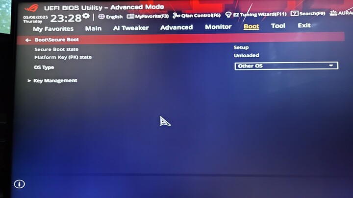

May need to switch secure boot from windows to other os for linux to work as well.

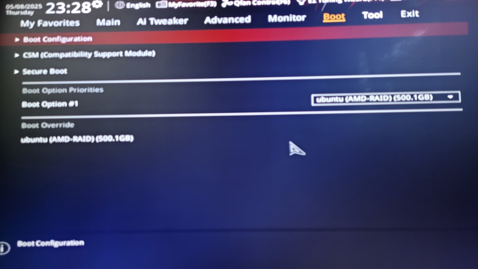

I don’t think it’s the 5090 that’s the issue now, I’m getting “failed to register the efi boot entry operation not permitted”. Grub isn’t grubbing? I have no Idea what’s wrong right now but I don’t want to reboot it because for the first time I actually have internet on this machine
Secure Boot is off/set to Other OS? Usually a clear CMOS resets that to on which only works with Windows.
That sounds a lot like a Secure Boot issue.
