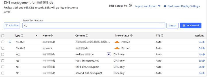

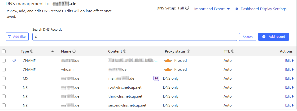

Aloha,
I think I’m about to cry :wink:
I just can’t get the reverse proxy to work.
Cloudflared tunnel is active and the public hostname is registered.
I entered the DNS entries like in your manual:
CNAME of @ is 7xxxxxxx6.cfargotunnel
But if I am trying to go to whoami.xxxx. I will get nothing.
I think there is a problem with the traefik.
Can you give me tipps? :slight_smile:
Greetings
Skinn0r
Here are pics:
next problem.
if I change the dnsmasq.conf (like in the manual), safe the file and restart pihole / traefik, the chages were withdrawn. Before restart i can update the filebrowser website und see the changes.
