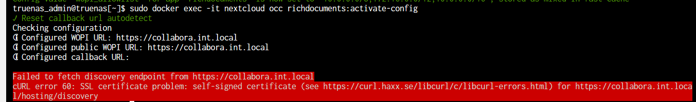

Nextcloud was not letting me choose database but it’s sorted now. However when I am at this stage I get the error about sel-signed certificate:

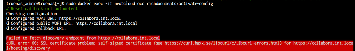

After making changes to Collabora I got this error:
Try using “http://” instead of “https://”…

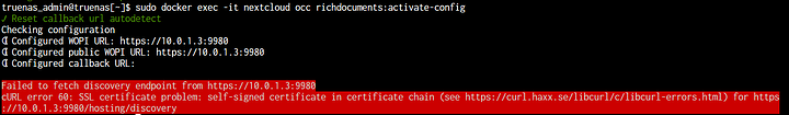

Unfortuantely that didn’t work either.
sudo docker exec -it nextcloud occ config:app:set richdocuments wopi_url --value=http://10.0.1.3:9980

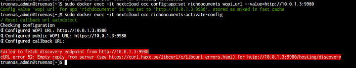

went back to http, got this:

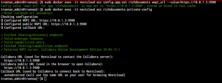

went back to https, and I didn’t get any error this time:

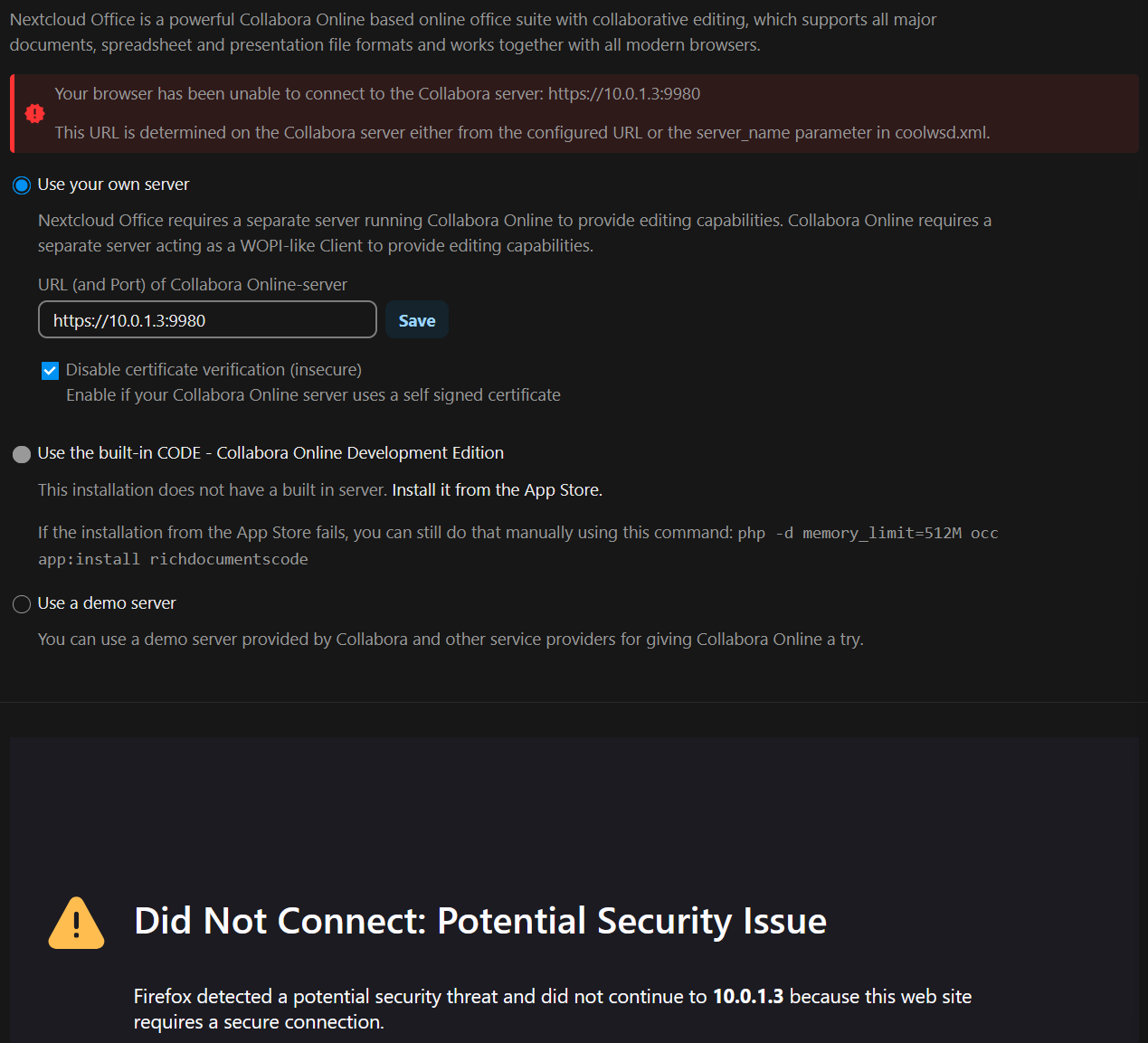

Can you reach Collabora’s Admin console?
https://10.0.1.3:9980/browser/dist/admin/admin.html
If yes, login into it and test the connection again in “Nextcloud Office”…
PS: What about the Whiteboard? Can you reach it using “http://” instead of “https://”?
Best regards,
PapaGigas
Both seem to work now, after I went to the Collabora console and accepted exception in Firefox. Same for Whiteboard.
