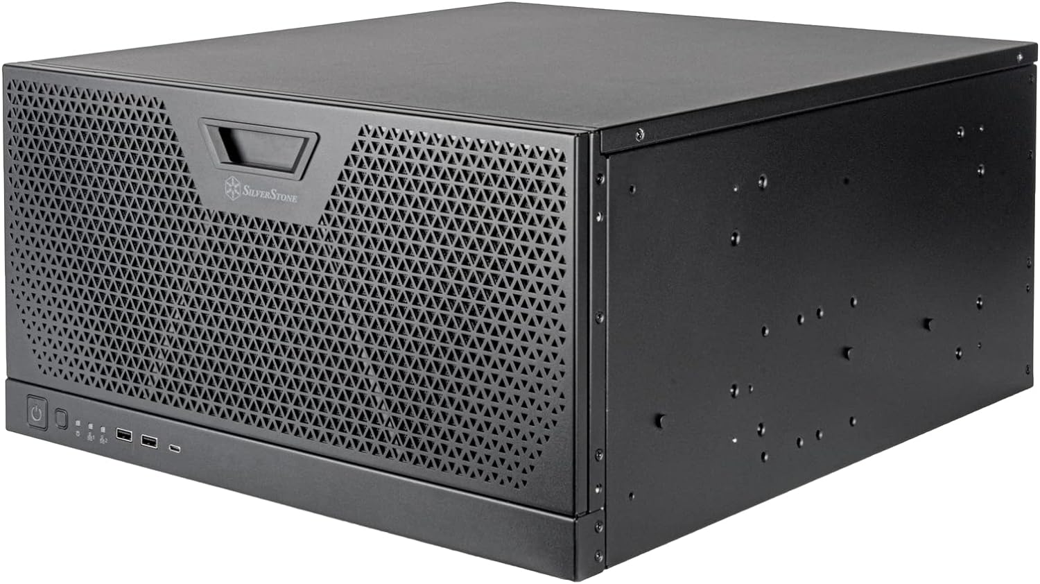

In retrospect Sarge, I would have gone for something like this: Its spacious enough to allow the installation of 120mm or maybe even 140mm Noctua fans.
rather than Sliger. Sliger is ok, it just have a bit of QC issues that I wish they would fix.

I’ll see if silverstone offers something with a bunch of 3.5in disk sleds. Or maybe I’ll have to get a disk shelf, not sure yet… :thinking:

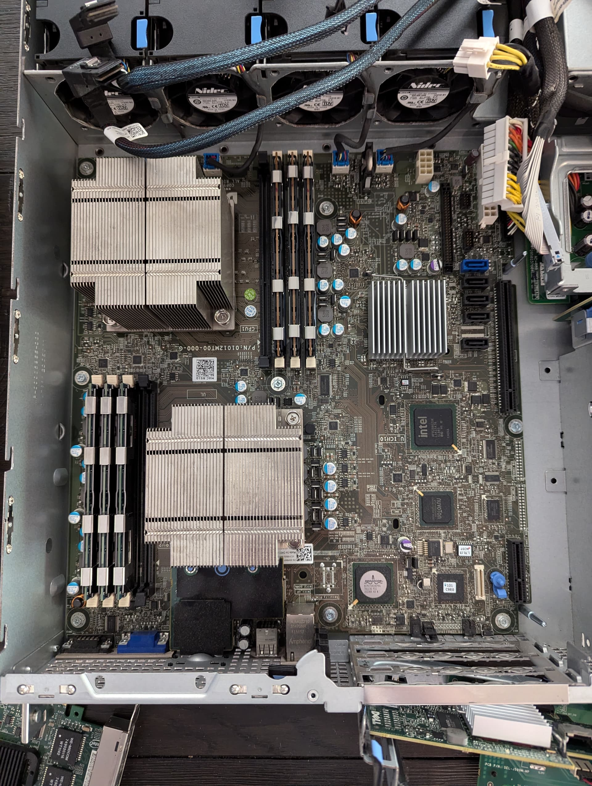

My thoughts on rackmount stuff is to just stack it on a shelf, rather than actually deal with rails. I’ve got 2 rackmount bits right now, a R510 which is just a big ol paperweight until I can get around to the fan mod, and a 10GbE 8 port dumb (passes vlan tags, so that’s nice at least) switch.
Maybe I should just do the mod on the R510 and call it a day with that. :thinking:
If you could use the R510, do the fan mod, and replace the R510 motherboard with either an AMD workstation motherboard (depending on your needs) or an AMD server motherboard. I don’t know if such a drastic modification could be done, but that is what I would do in your shoes.
Not a terrible idea, but that’s a lot of work haha. Pretty sure the R510 is doing proprietary board form factor here as well, so I’m not sure it’s helpful.

My thought process was that you already have a case with the R510, so why recycle it and purchase a new case? If I had an R510, I would see if the mod I suggested could be done. I am saving for a second—or maybe third-generation used AMD Epic system and a rackmount case for it. If I went with a Theadripper, I would purchase it from Puget System instead of buying the parts myself and putting them together. I think you won’t save much with a new system.

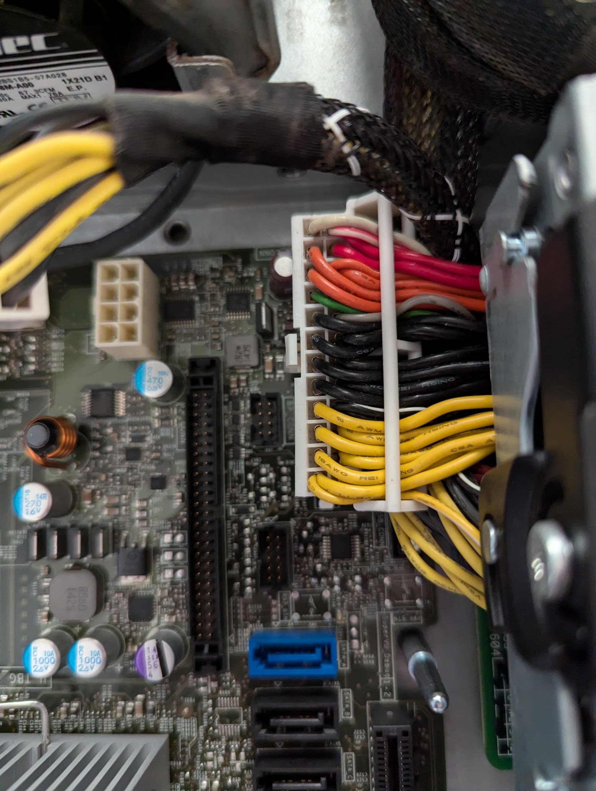

So it looks like tbe power supply is a standard ATX 24 pin, with a supplementary 12v 8 pin for the CPU power.
This might actually be doable. I’ve got an old xeon motherboard i could test this with. Would probably need custom heatsinks though. :confused:
While it does look like it might be a somewhat standard screw post pinout, its not am ATX standard.
Im thinking i miiight be able to fit a matx board in here?
The issue is the power supply connections. Id need to get extensions to run them where theyre needed. But at least i wouldn’t have to solder the fan connectors on a standard motherboard for the noctuas.
That 24pin ATX pinout doesn’t look right to me
Dammit You’re right.
Way too much 12v and it’s completely pinned wrong.
of course I’m making the assumption they actually color coded the wires to their voltages.
Yellow is +12v
Orange is +3.3v
Cant read the others.
Here we are…
Dell pinout:
ATX Pinout:
So it looks like… we’re missing -12v and possibly the green power-on signal. If 4, 5 or 16 are the “turn on” switch, or maybe the server supplies are always on? I’m really not sure.
So the question is: are -12v and the power-on signal carriers needed?
It goes without saying, there’s a lot of +12v, and not enough +5v.
To be clear, I’m in the process of considering a pinout-conversion, of sorts, where I just take a custom 24 pin extension kit, re-pin it so that it converts from this proprietary pinout to ATX, and see if an old motherboard will boot or if I just made a smoke machine.
