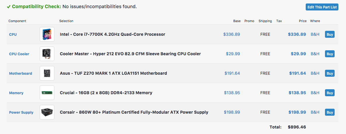

So this is the totally overkill build I’ve gone for -
Link to the pcpartpicker config above.
Couple things to note -
  • It will run an OpenVPN client (at least 1), and I plan to assign VLANs and potentially certain MAC addresses to that egress route.
  • Suricata will be run for Intrusion detection/prevention, and from what I’ve read this is processor intensive. Latest versions needs AES-NI on chip for all the crypto related stuff that it offloads to the CPU. This is why, the 7700K isn’t entirely insane of a choice here.
  • the 7700K also means I don’t need to add a GPU.
  • I ultimately went with the TUF Mark1 as it has Dual-GigE ports. Having WAN/LAN at the start is all I need to get off the ground.
  • I’ll most likely slap a Noctua in this if the Coolermaster has any trouble.
  • Chose bog-standard RAM. Nothing fancy. Crucial are a solid choice though, been choosing them for over a decade easily.
I’m running 3x Corsair AX860i PSUs here, 1x HX1000i and 1x HX750W. I believe in buying good PSUs; they’ll generally perform longer and be more efficient in the long run.
I am expecting to receive my order later this week, just hoping customs won’t hang onto it for too long though. Will post an update once I start on the build!
Thanks, do let me know your thoughts!!
Overkill is an understatement :open_mouth:
You could have gotten more than adequate performance with an i5. An i7 won’t even work up a sweat, but you shouldn’t loose much if any of your bandwidth.
Maybe money better spent on low power equipment. Build an 80watt xeon (or less) with a little ecc ram, an ssd and a quad port intel pro/1000 nic.
Also include a high quality UPS with enough capacity to handle your pfSense box, switches and modem for 30 min or so…

That said the hyper212 will be great at stock speeds, and an OC would be just silly when your using a modern i7 just for a home level router… PF sense would do normal duties on a 6w SOC, and adding Suricata only bumps your actual needs up to modern i3 levels as ALL skylake parts have the correct extensions (a change from the past when the Pentiums and celorns did not, just as in the past K series parts missed out of virtualization extensions).
The PSU is also an odd choice… why 850w? Best efficiency is ~50% load, and a titanium rated supply that does more than your actual wattage as 50% rating is worth less than that.
All in all I don’t really understand… a lower power use xeon with similar (or even more) ECC memory and duel NICs would cost less money, even buying new with longer warranty than the consumer stuff.
Why not get a CPU with an higher core count and a lower TDP instead? I think a low power 6/8 core Xeon might be a better choice if you want to go overkill and you’ll get better overall system reliability with server parts. I know even consumer parts, if used wisely, last long and don’t have any issues but why take even the slightest risk? Also, since you’re going to make such a machine you’re not going to need all the PCI lanes so having a system with expansion cards it’s not and issue in my opinion.

@SheepInACart - valid points there for sure. Went with the 860W cause I have a couple of them already; if any of my other systems ever need a replacement PSU for the short-term, I can cannibalise this one. I tend to do this in a hurry, since ordering a replacement at any point means there’s a 12 day wait usually once factoring customs.
No OC on this, it’s already over the top hehe.
Would have liked to have gone Xeon, but sourcing specialist stuff is very hard as I can’t order from say NewEgg/Amazon etc. It’s a total pain.
@MetalizeYourBrain - well, I’ve got the parts arriving today/tomorrow; I would have preferred WS/server grade components for sure; will see how long this lasts and if things so go sideways, I will replace with server grade stuff.

Before I list any other actual recommendations though, a note that Suricata only used to be super system intensive and not well threadable back before 2012 (and then only 4x more than Snope), so for an example to run home how overkill your idea is these days; The E5-2680 0 @ 2.70GHz, an 8 core hyperthreaded xeon, was demonstrated to l push 10 gigabits through Suricata in 2012, you need 1% of that traffic, yet due to processors improving in the last 5 years and the higher clockspeed of consumer parts your i7 7700k is almost the same raw work potential… scaling is not perfect but your on the order of 100x more CPU than it needs to be at minimum, and >5x as big as I’d buy.
That said unless you already have the i7 and not another use for it, I’d recommend just keeping using it, you won’t save enough power with anything that you can put in that socket to make it worth the swap. I say that because even though its a 88w part vs a 16w-35w, those are the peak operating numbers, and at idle or low loads it’ll be much more even as the i7 won’t push to its max clockspeed and thus will run at less voltage (in fact you could even underclock\undervolt in the bios if you feel like it… 3.0 ghz would be heaps for your needs and allow considerably lower voltage). Underclocking could maybe have the TDP of your i7, so ~44w to 35w, which is not so bad.
If you don’t already own you CPU or Mobo the most import question is how fast is your actual max linespeed. Since if your on a nominally 100 megabit line even if only get an average of 40 megabit, it still can on a second or so level arrive as a short burst at up to the 100 megabit rate, so the systems needs should be specified to that. Also the rough rule of thumb is you get about 200Mbps per modern Suricata and bro worker, so two modern cores at regular enterprise type frequencies (3.0-3.5ghz) would handle your traffic with a max of 50% load. Thus don’t shy away from a lower wattage xeon, it’ll get the job done.
16gb ram is perfect for your needs Suricata wise, you’d probably get away with 8gb but no reason to push it. I fully support going for 2 non-fancy DIMMs from a good company so you can upgrade RAM in future. Motherboard wise you have no special needs… so the most basic server board with duel gigabit NICs will do, and normally basic is good for reliability, power use and your wallet, especially vs a gaming mobo. I also recommend going mITX and getting a cheap tiny case that can go on a shelf with your switch and modem, you don’t need the space (no expansion cards) nor want to be running high wattages or many fans.
A 4 core atom SOC board would be perfect for your needs, >25% of the i7’s performance, 4 threads, duel NIC’s and 4 ram slots on a 16w passively cooled mITX form factor, and yes, something new like the C3558 has the AES-NI on chip (and all the virt extensions). A weird but cool feature they have is the ability to run off 12v DC only OR a normal 24 pin ATX connector, so you can avoid stepping up to mains power from your UPS to run an ATX PSU to turn it back to 12v DC… which can save money, space and power. If you need more threads, there is the 25w 8 core, but beyond that the 35w xeons make more sense.
Link to atom SOCs: http://www.supermicro.com/products/motherboard/atom/
If your doing full packed capture you’ll need big amounts of storage though, as in twice your highest average actual line traffic rate over the time you want to keep logs multiplied by the number of seconds the log is for. In other words if you pull full 100mbps all day and want 48hrs logged you’ll need a terrabyte. A week will fit on a 4tb drive, and I’d consider something basic like raid1 if this is actually critical to you (no real need for ZFS or anything though).
Finally you NEED a good UPS. Lots of these features hate unexpected power offs and will give buggy performance on a partical brown out untill next propally power cycled. It only needs to last long enough to shut the machine down (from full load and once the batteries are at your nominal end of life), but it needs to be present and work.

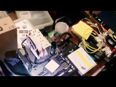

Initial stages to the build - smoke testing on the table, and the case arrives from the US
