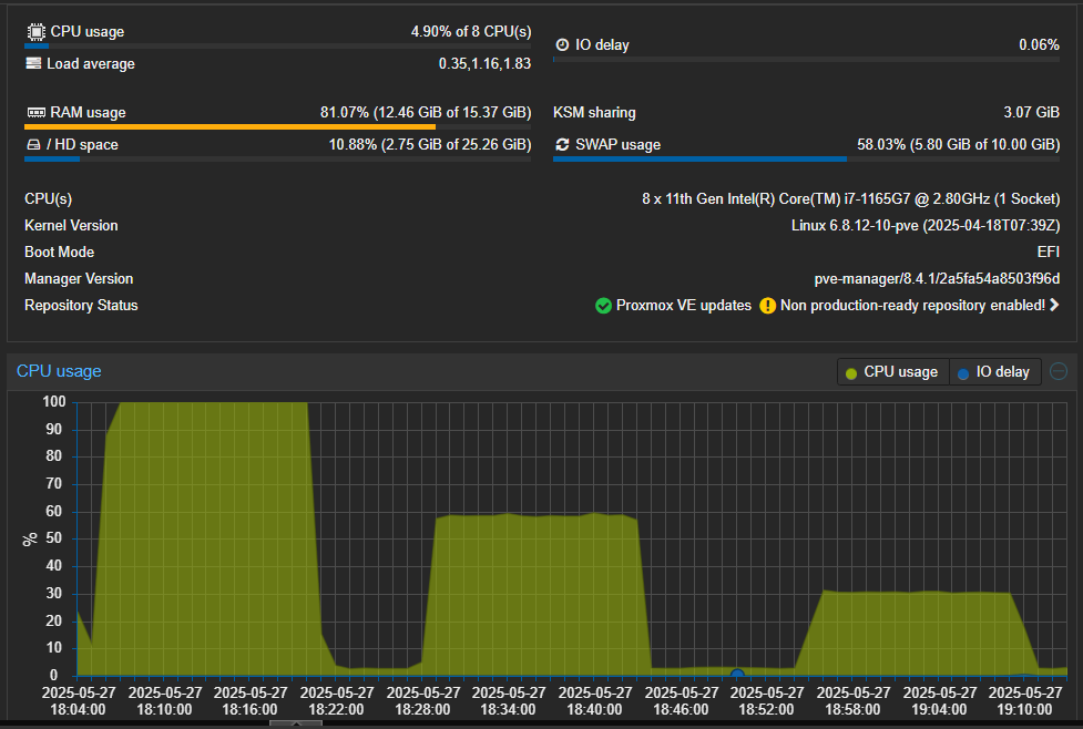

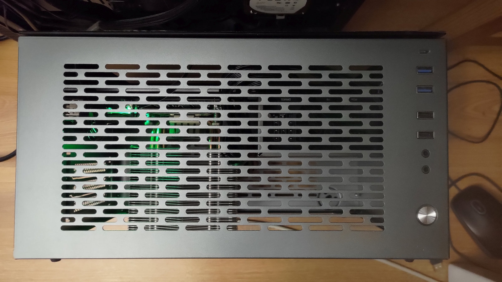

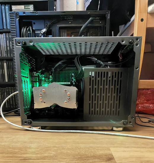

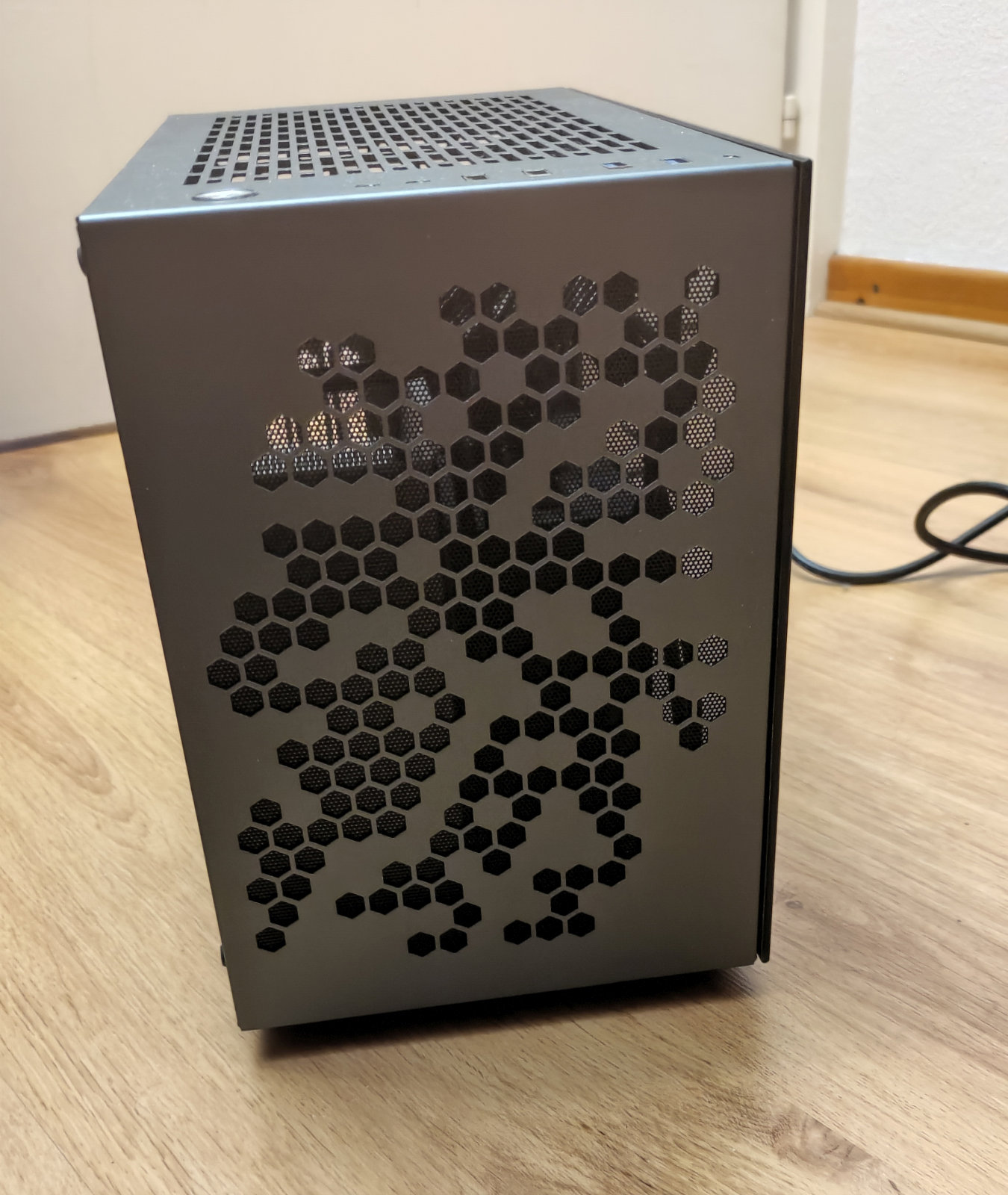

The build is finally finished and running along nicely as a proxmox host.
Initially was aiming for a passive build but had to reconsider.
All in all quite happy with the result, with a bit of TDP tuning, temps remain very reasonable.
  • Case Kolink Rocket Heavy Mini-ITX
  • Motherboard Topton Intel i7 1165G7 4x i226 2.5G 6xSATA 2xM.2
  • Radiator old Tranquillo Rev 2
  • Power supply BeQuiet SFX-L Power 500 W
