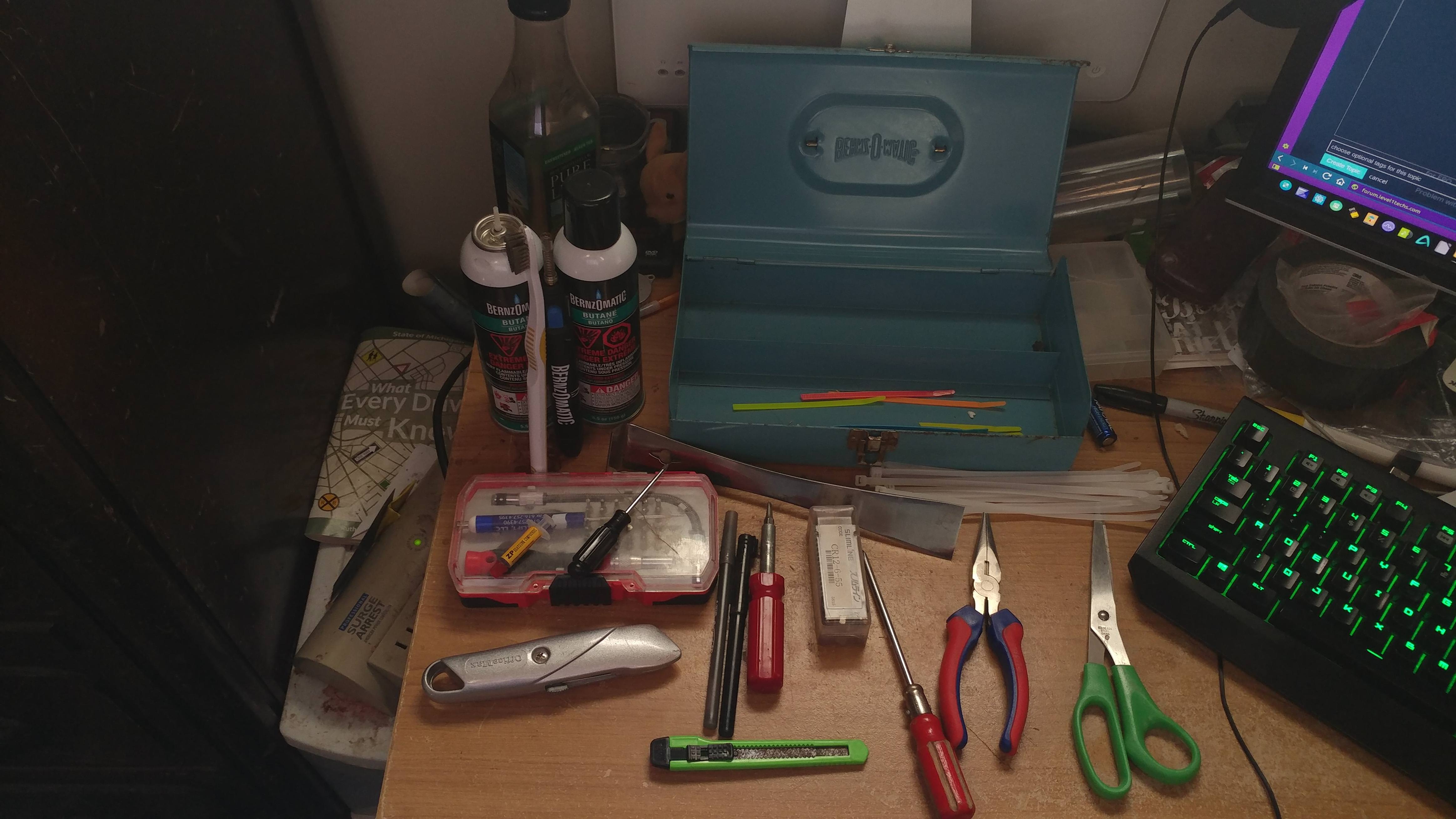

So, heres my basic toolkit for any PC project I have.
Pictured are:

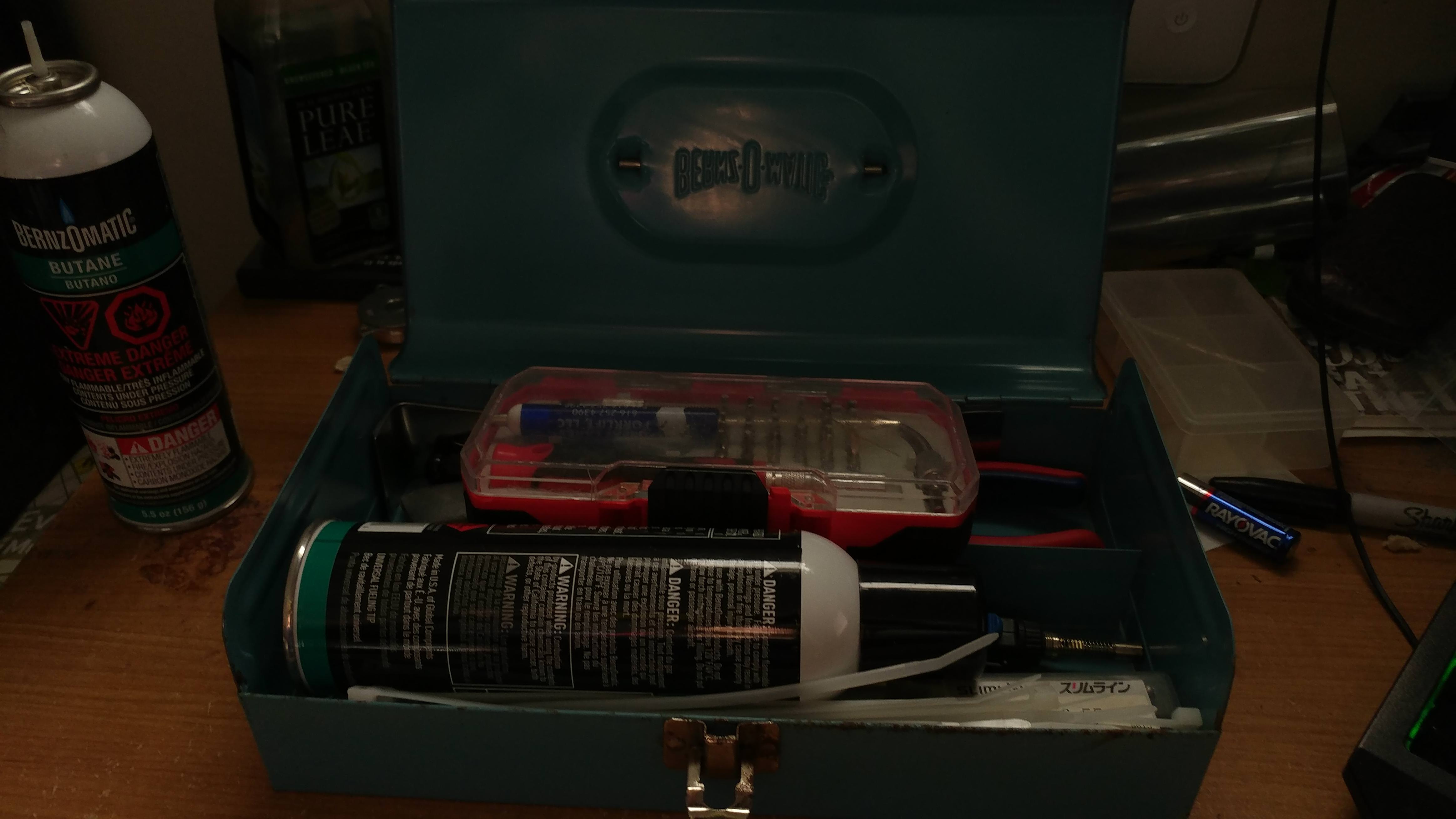

XActo Knife, Box cutter, Zip Ties, 1FT pry bar, shitty scissors, small screw driver set, pen + marker, therm paste, tooth brush, gas bottles, gas-heated pen soldering iron (that I managed to lose the tips for >:T), reversable screw driver, shitty screw driver I don’t care about that I use as a chisel, gas-bottle toolbox to keep it in.
All my tools that I use all fit in this little box, minus the second gas bottle that I don’t need to carry around.
