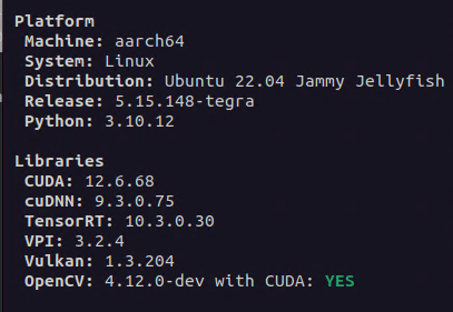

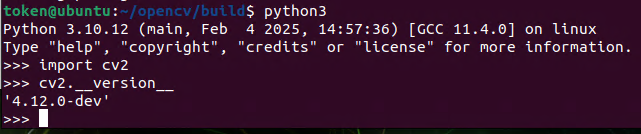

Anyways back to scheduled ‘break sh*t’ programming. Installing opencv to do face things:
OpenCV will be installed to the /usr directory, all files will be copied to following locations:
  • /usr/bin - executable files
  • /usr/lib/aarch64-linux-gnu - libraries (.so)
  • /usr/lib/aarch64-linux-gnu/cmake/opencv4 - cmake package
  • /usr/include/opencv4 - headers
  • /usr/share/opencv4 - other files (e.g. trained cascades in XML format)

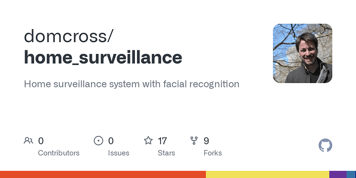

Installing above because of below thread:
Then attempt installation of the docker tool “home_surveillance” also specified in thread.
Tried to install portainer to help rangle my containers but that seems to be a no-go on the Nvidia Nano even with chatgpt trying to help.
kudos to the qengineering.eu 'install OpenCV …" tutorial, rarely RARELY does a tutorial actually go smoothly and in their case also add in a lot of context and clean-up steps. Only issue was qt5 not being in the repo anymore.

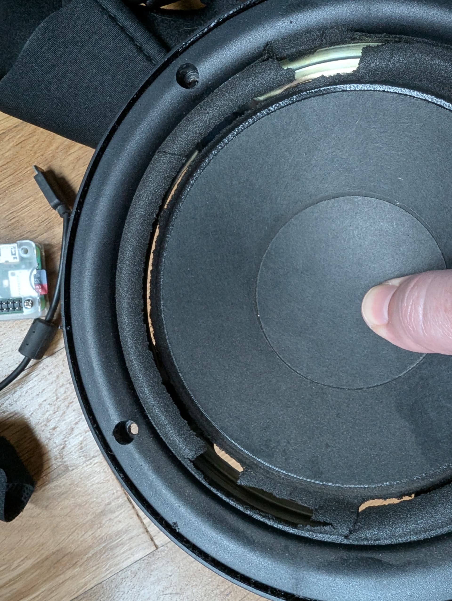

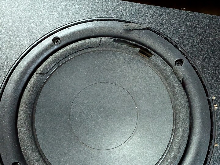

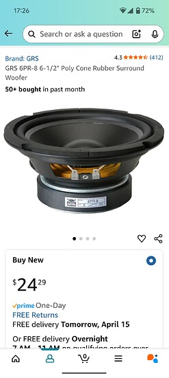

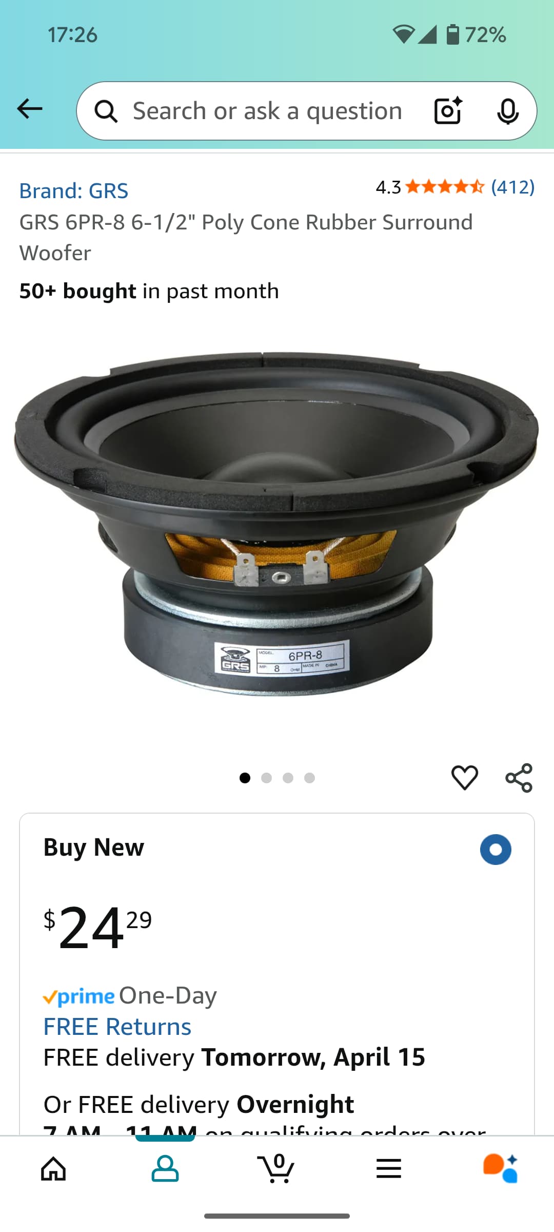

My Klipsch 2.1 sub started to rattle.
Yep, thats probably the culprit.
YouTube sent me to this replacement and the reviews seem good.
You mean Amazon? :slight_smile:
YouTube referred that speaker model then i Amazoned it haha.
The reviews are actually pretty hit or miss, this speaker seems to be a noticable downgrade but for me it will sure beat the nastyness coming out of it now.
Interesting material, everything was great then blamo, massive disintegration.
F me… My head is not working today… I read it as YouTube sent it to you and I wonder what the point is… And my stupid head read it as “YouTube sent me this replacement” and I wonder since when YouTube sends speakers. :slight_smile:
LOL
I used to have Sony headphones, after a few years of them lying in a drawer I reach for them and the foam sponges that cover the plastic turned into dust, literally disgusting black dense dust. :slight_smile:
Was the speaker exposed to sunlight?
Material fatigue, weakening due to UV radiation, deteriorated material integrity due to time.
It is quite often seen with various foams, sponges, plastics. Many plastics in a car in the engine compartment after years crumble and crack once you turn something and everything breaks.
I also had zip ties that fell apart, even those that were not in the sun because they were inside PC. :slight_smile:
My theory is simply some manufacturing process/chemicals are or are not used that negatively affect the length and quality of the material.
No sunlight. I feel like you said, either unintentional or maybe intentional planned obsolescence by material/chemical choice.
Installed the new speaker, like some of the reviews said it doesn’t punch the same and now i also have to crank the bass way up but it’s better than nothing/fart noises.
I thought these were supposed to be made out of canvas so these kinds of deterioration wouldn’t happen before 100+ years
This brand seems like paper.
Im not complaining, for the price the performance has heen stellar and ive had them for 10+ years.
