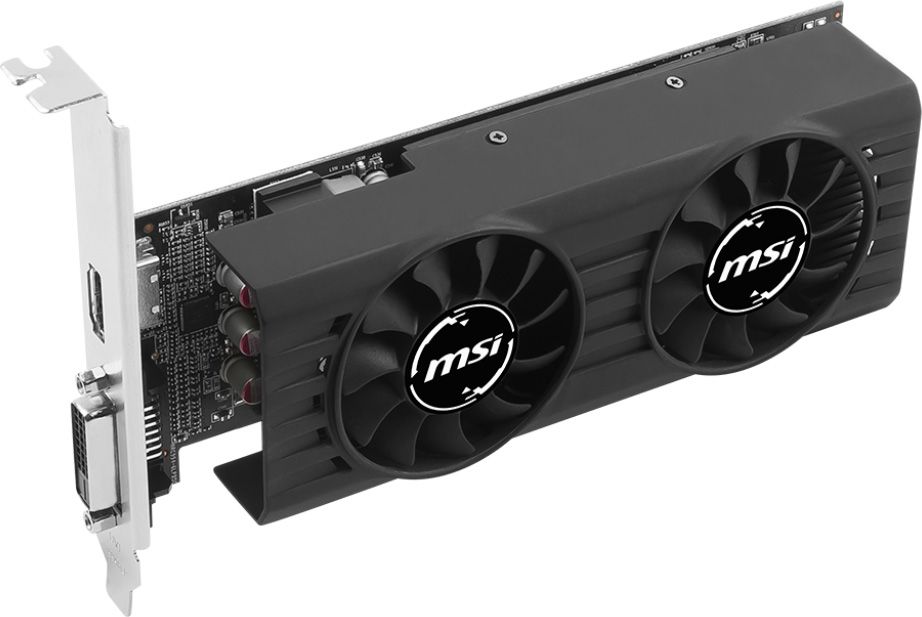

If you're going that route you might want to try and find one of the low profile 1050s or 1050tis.
Although I still vote for custom loop with a 480, just might need to drill some holes and make the tubing external, should make it look like bane or something
http://www.anandtech.com/show/11094/galax-adds-lowprofile-geforce-gtx-10501050-ti-oc-lp-graphics-cards-to-lineup
And actually MSI just announced a low profile RX 460 that'll probably be available in the US
