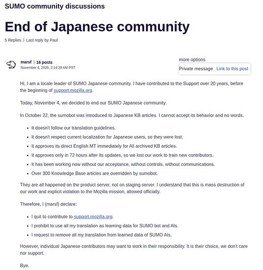

Source
I was not aware of that but that is about what I expect companies to use AI for. Someone sat in a meeting and then snorted a 10 inch line of cocaine and then declared let AI write all support articles. At least that is kinda my personal expectation how these things get decided.
