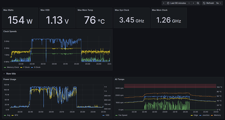

I made this little ruby script and some config files to monitor AMDGPU stats with Grafana via Telegraf and InfluxDB. It uses the JSON mode of amdgpu_top to collect them and feed them into Telegraf.
I started off with a simpler method, using the script as a plugin to Telegrafs input.execd plugin, but the telegraf user doesn’t have access to whatever memory the amdgpu_top needs, and thats probably for a good reason. So the next best thing is chucking the influx line protocol at a TCP socket as a systemd service.
If you want to copy it check out GitHub - penguinpowernz/amdgpu_tig: TIG stack for monitoring your AMD GPU in Grafana but I’ll copy the instructions here too:

Oh yea plus when you login to grafana setup the datasource to look like this:
And you can grab the dashboard JSON from the repo and import it.
