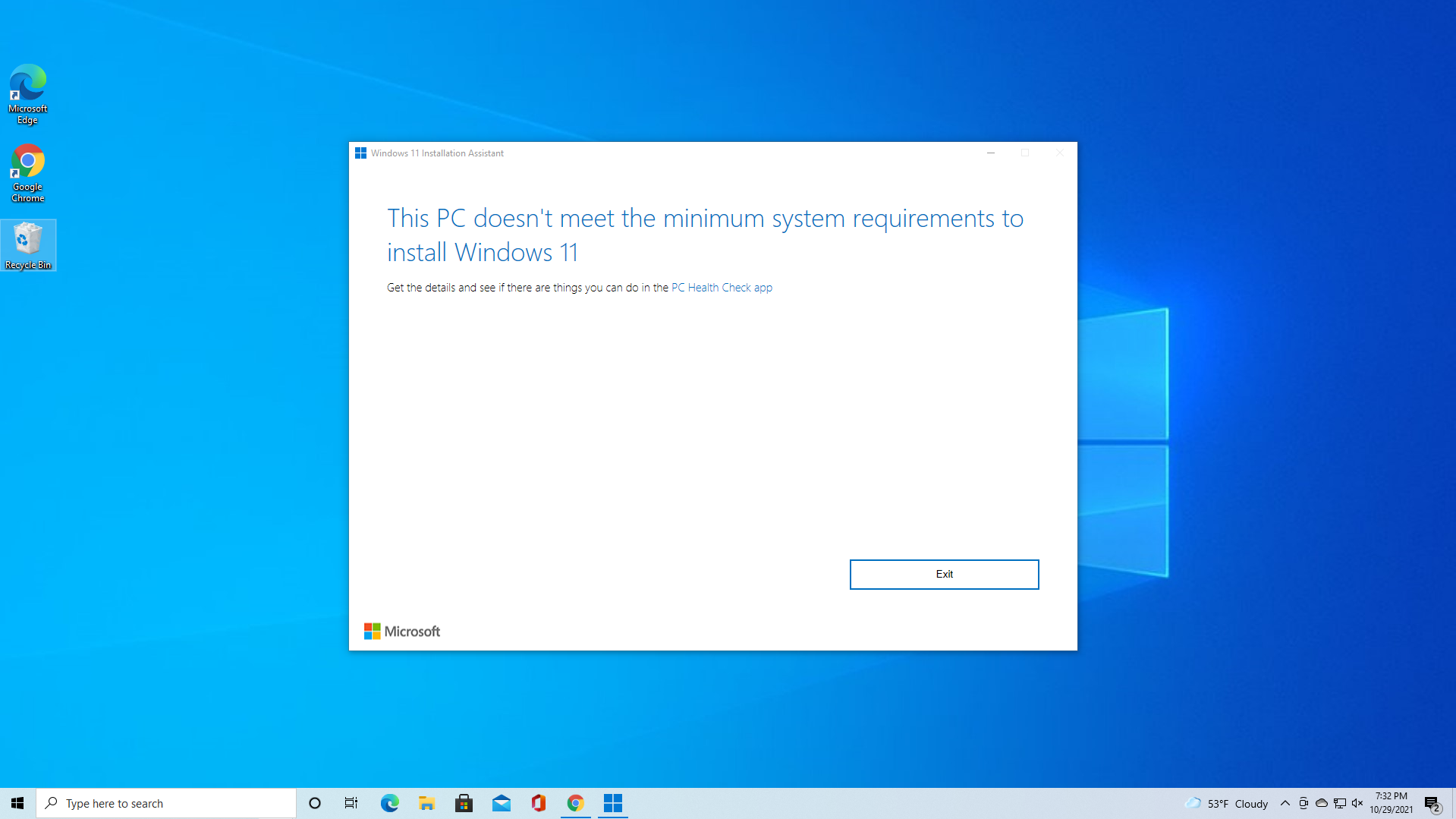

Issues now is that I can’t get Windows 11 installed without it generating a Driver PNP Watchdog error message.
So resetting and the Windows 11 setup reverted back to my current version of Windows 10 Pro.
I did confirm that the system met the requirements and even the TPM settings were enabled in the BIOS and seemed to be supported.
My question would be IF maybe one or both of those SATA storage devices is causing a problem and if I can just disable them within the BIOS ?

Try removing some sticks of ram to basic needs and see. Did 10 install fine before?
Yeah that is the thing, the initial Windows 10 Pro install worked fine from a USB install stick.
The only difference was removing an older spinning rust HDD and maybe the BIOS being updated, but not sure about that as there hasn’t been any updates for awhile.
With the newer versions of Rufus it is even easier, worked with my 2920X system
How to Bypass Windows 11’s TPM, CPU and RAM Requirements
