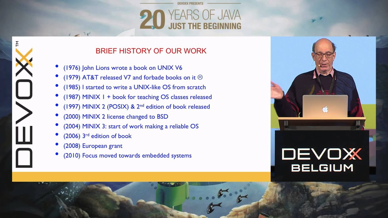

The current version of MINIX, with its minimalistic kernel, ability to update core components on the fly, and other interesting components like the Reincarnation Server (not unlike Supervisors in Erlang) and isolation of the various components by way of permissions (managed by the kernel), etc. make MINIX very interesting (to me, at least).
The only thing I wasn't able to understand very well was how a driver or other components ask for permissions (on installation and/or later) and how the kernel intrinsically understands that, for example: an audio driver is not supposed to write on the disk. The POLA concept mentioned in the video below is simple to understand, but its implementation is a bit confusing. Can anyone shed some light on that?
(Fast forwarded to the 10 min, 56 sec mark)
Andrews opinion on Hurd (from OP's video).
Basically he says, "where is it?"
