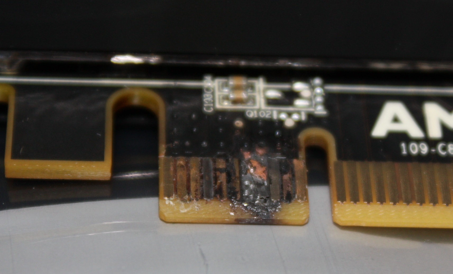

A mother board and a graphics card I’m now scared to use. No performance loss before I shut it down. A wonderful burning smell though.
5 weeks in. We shall see what Swiftech warranty support is like.

What damage has been done is already done.
Let it dry completely (a few days), try to boot. run some tests.
That gpu and slot are probably unusable though. And you may want to make sure there are no shorts.
I’ll be honest, I read the title and thought, “Someone must be buying some cheap diapers.”
But yeah, that looks bad. That slot is probably no good. That area is where all the 12v and 3.3v power lines are which is why the corrosion and heat damage is so bad. ![]()

If you are very careful, patient, and lucky you will be able to use the gpu after you separate and clean the contacts assuming there were no shorts on the GPU board.
As for the slot I would try to separate and clean the contacts then never use the slot again. Might as well desolder it off the board if you are brave enough to do that.
If you manage to clean up the GPU enough you could test it in a scrap computer and see if it will work.
If you don’t want to go through all of that or you deem the parts irreparable then you should just replace them.
I recommend replacing the damaged parts if you are financially able to do so, just for piece of mind.
Looks like it got hot enough to melt the solder in that area, GPU probably won’t work again.

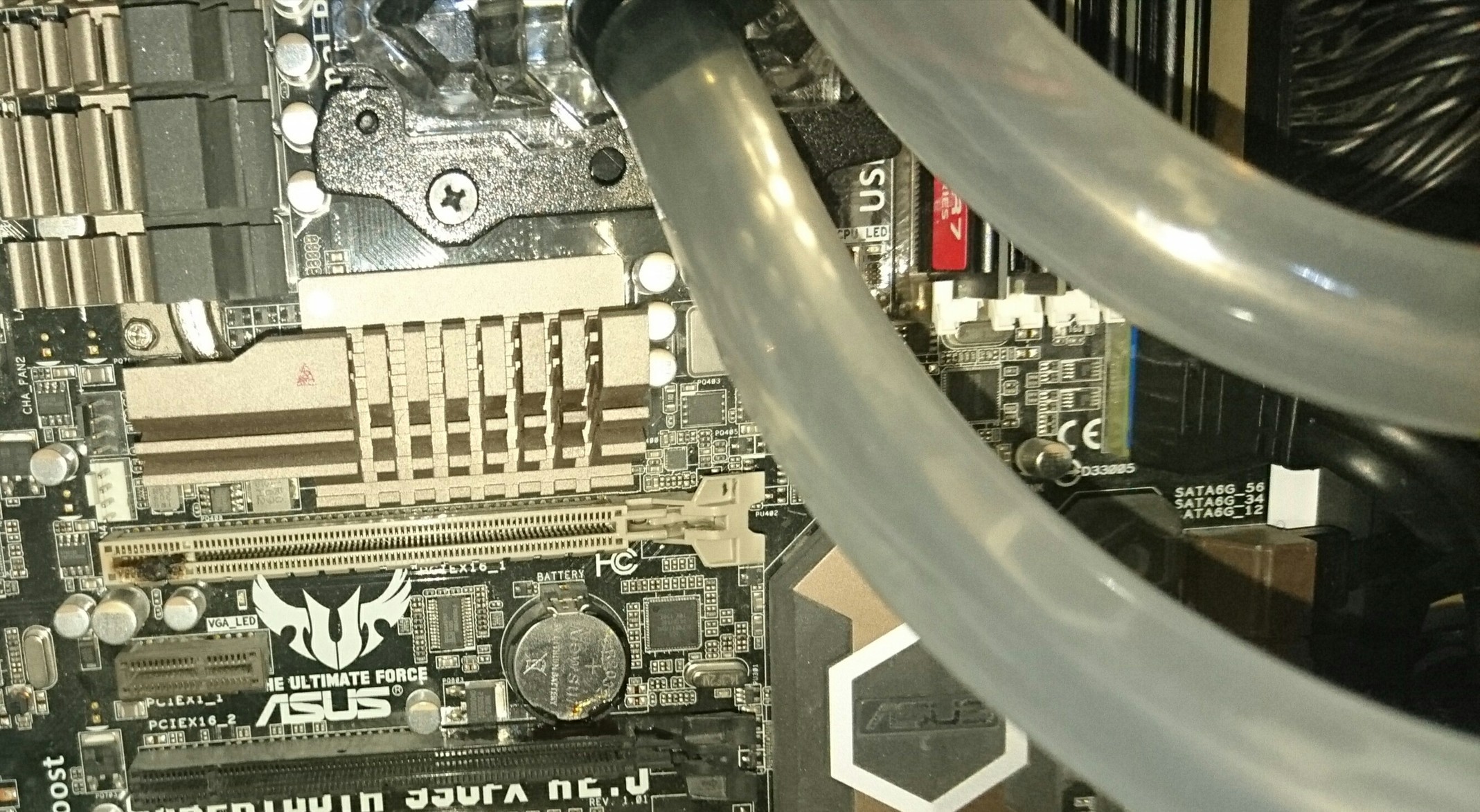

Mine questions are more what fluid was it, what was the loop and how did it fall to left corner of CPU block?
As the damage, clean gpu, clean slot and use another slot in the future. Good luck on the RMA, hope it was defect of product, as they need to cover it, had happen with a friend with a acrylic top that cracked (Raijintek).

The loop was just how the stock H240 X2 is configured. IT leaked out of one of the 360 degree swivel connects on the CPU Block, ran down the Northbridge heatsink. pooled onto the GPU, and spread across the top PCI-E slot.
It only shorted out and damaged the x1 section of the slot because that is where most if not all of the wattage runs through if I’m not mistaken.

Did you make any progress? I think you might be able to use the gpu if you clean the contacts up enough so that they look like contacts and not a solder blob.
I have a few ideas as of how to do it but using chemicals (electrical contact cleaner) is probably the safest way.
If the contacts are damaged you might be able to solder a ribbon cable between the gpu and a m/m pci adapter. It would be a huge pain in the ass but you might be able to use that card again.

Definitely won’t go for the ribbon cable, seems like a solid enough idea but I’d really like this to work again without a Macgyver’ed solution. If you look close you can see one of the pci-e contacts is burnt clean off, another is loosened off and crooked.
What you can’t really see in the photos is that on the contact that is about a millimetre of silicon is vaporized and you can see the copper of the PCB.
