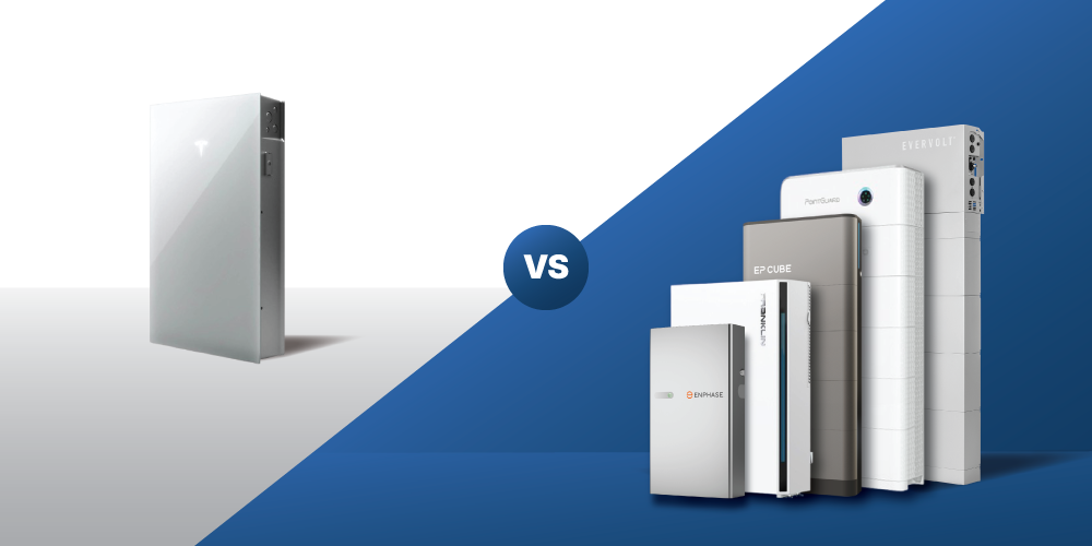

Third, try installing a 10 kWh home battery like a Tesla Powerwall and hook the ACs through that. ACs will draw power through the Powerwall when on, and when not the powerwall will charge up from the grid, which frees your 30A to other things.
Just a few different angles to approach the problem. As a bonus the powerwall will increase your house value.

It is feasible but would require the cooperation of the landlord in this case. I would talk to your company about it and see if they can sponsor part of it, or even buy the entire equipment if the landlord is unwilling to foot the bill (understandable).
The reality is, not every home is built for a massive 1000W computer. Here is an overview of powerwall alternatives that you might investigate further, this heavily depends on where you live.
