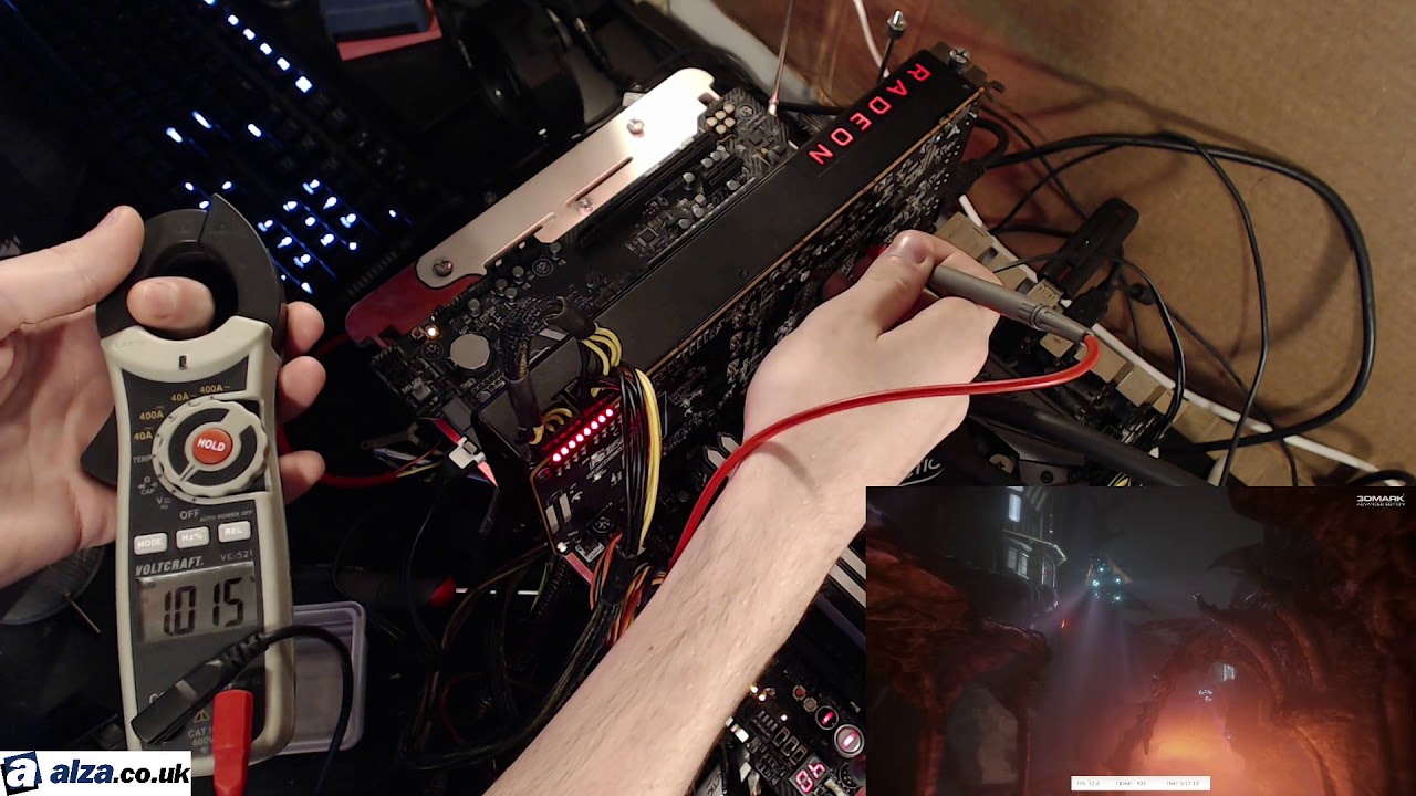

Anyway, thought I’d toss this in here. Buildzoid going over his experience with undervolting Vega 64:
