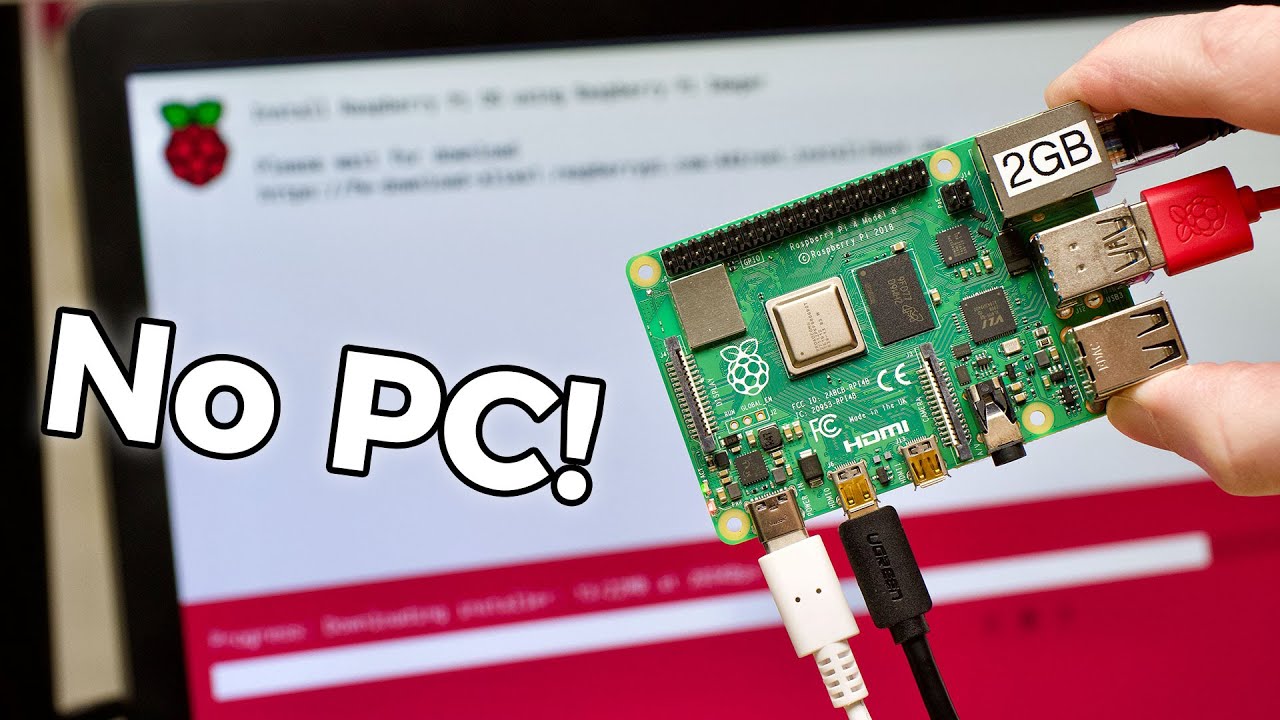

@geerlingguy covers the new beta of Network Install:
Yeah, the inclusion of pi 4 images is nice, I still have my original self-compiled image running and it’s still going strong. And Void has a lot of packages in the repo. But, for the Pi, especially if you run one with <2GB of RAM, I would highly recommend Alpine if it fits your needs.
