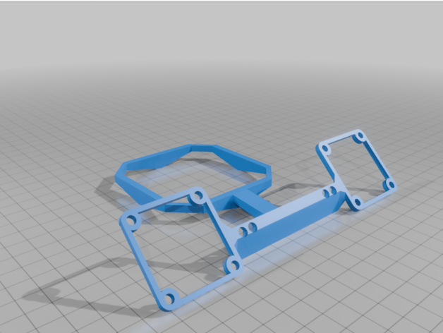

With the Meshify 3XL how is the cooling for something like a U.2 drive 2.5" drive? Looking at the manual it looks like they would have you install them either one at the bottom of the case, or two on the “side/floor” under the motherboard?
there’s more airflow on the bottom than behind the mobo tray. the bottom is fine if it’s not going to crowd your other cards

and @H-i-v-e were you talking about these
