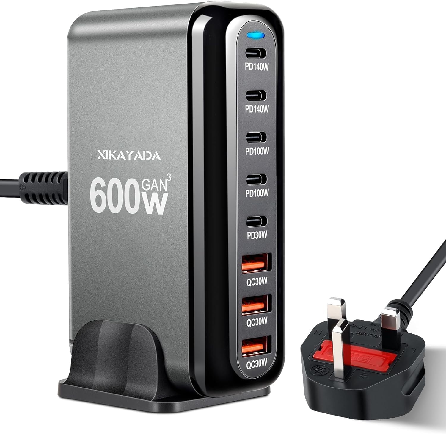

Just to confirm that I have had no issue with multiple HP docks at work, I have had no success with 65w PD but anything 100W and over has been no trouble.
To add to the links, this low cost charger works fine

Charging
On the provided USB-C power brick everything is fine, however of the other multi port 140W USBC PD chargers I have just seem to ramp up to 100watts then drop to below 25watts and start again
The chargers i have tried are :
- ISDT Power 200X (has an LCD readout of current charging rates)
- Rocoren 140W GaN USB Charger PD3.1
Both experience the same issues, unsure what the root cause should be (i have also tested multiple USBC PD EPR / 240watt cables with no luck)

For charging, I’ve been using the Sabrent 252w charger that Jeff Geerling featured a while back with some Ugreen cables (240w, 40gbps, 1m/3ft). It only does 100w, so under windows it won’t run at max performance and there’s a HP nag notification. But, I have no problem charging and running the laptop in my normal usage with windows or CachyOS.
@BuzzBumbleBee I think the full power draw, followed by a ramp up from lower is part of the normal power negotiation (It’s what I see on my charger). It should just happen once at connection, if it’s recurring after there’s an issue causing/forcing renegotiation, it could be either the cable or charger.
