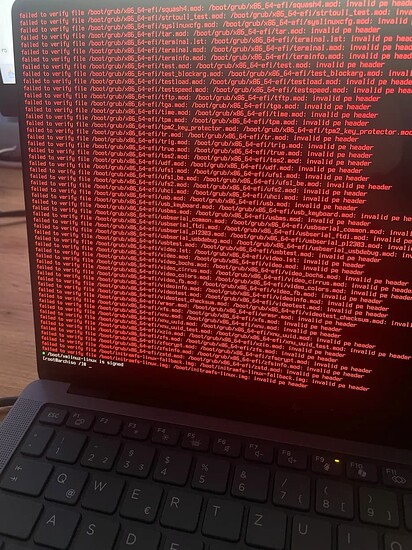

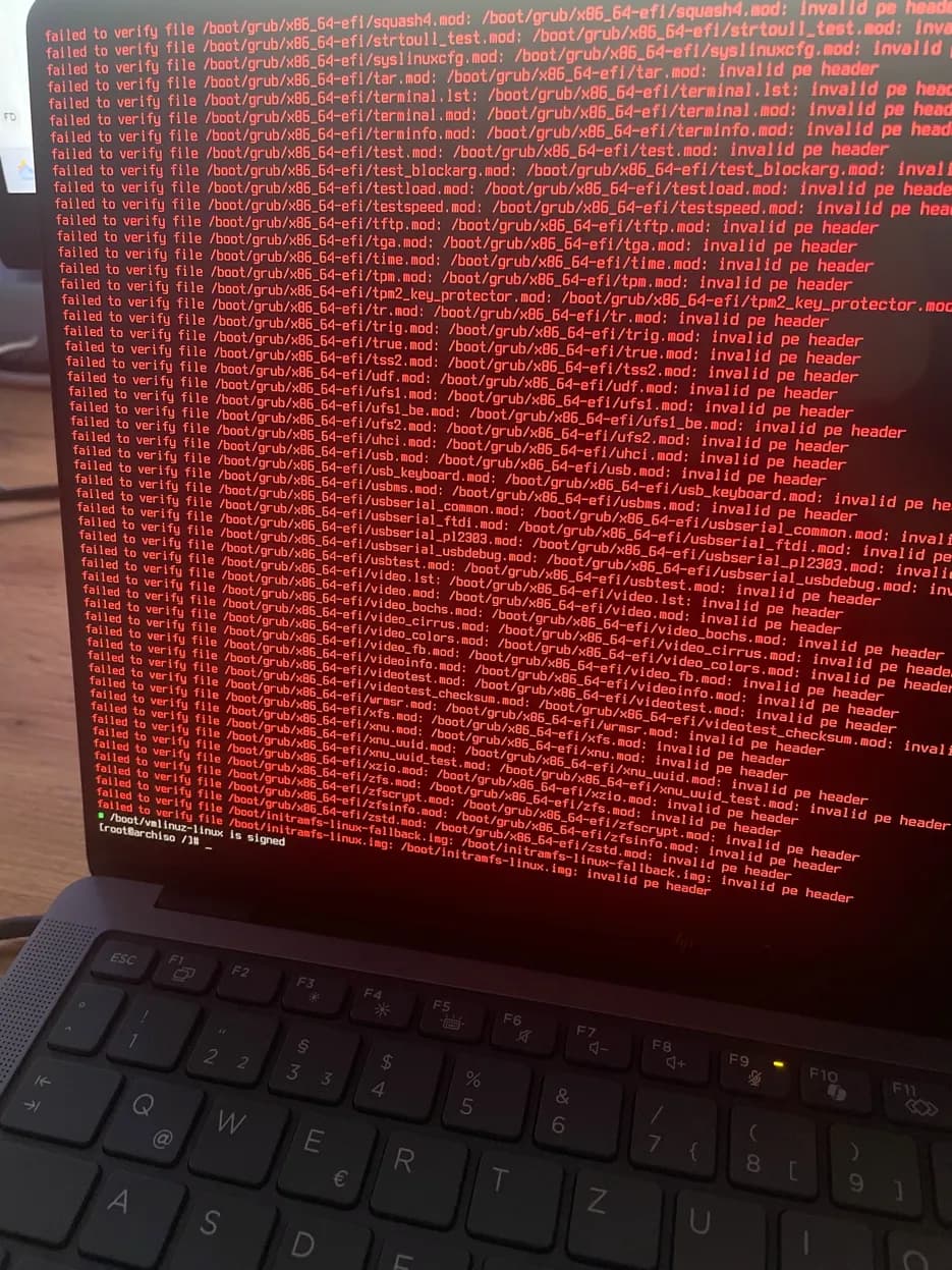

Now I had issues with GRUB and the Secure Boot keys. After manually running pacman -S grub efibootmgr for GRUB and manually creating the /boot/grub/grub.cfg file, I had issues with signing the EFI files.
/boot/EFI/GRUB/grubx64.efi worked, but sbctl sign /boot/EFI/BOOT/BOOTX64.EFI said that no such file exists. I attempted to fix it by manually copying the files:
mkdir -p /boot/EFI/BOOT
cp /boot/EFI/GRUB/grubx64.efi /boot/EFI/BOOT/BOOTX64.EFI
but after running sbctl verify there were a lot of unverified files (full screens worth):
tried powering through, and the next command was also problematic, but aperently it is a typo:
sbctl sign /boot/vmlinux-linuxsbctl sign /boot/vmlinuz-linux
Not sure if this /boot/EFI/BOOT/BOOTX64.EFI issue will cause problems later, but I was able to boot into the system after the reboot and the Secure Boot is enabled in the bios.
