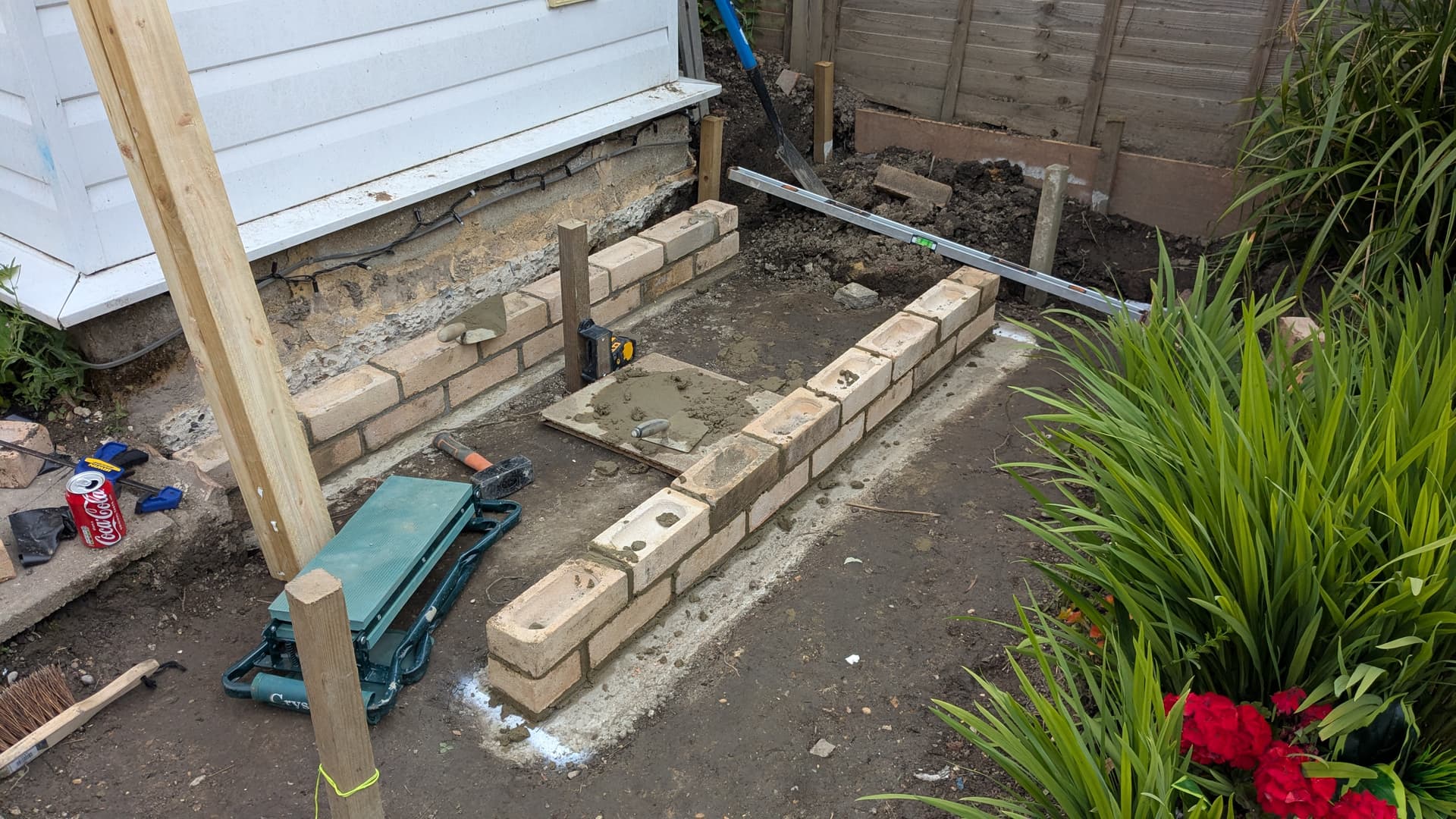

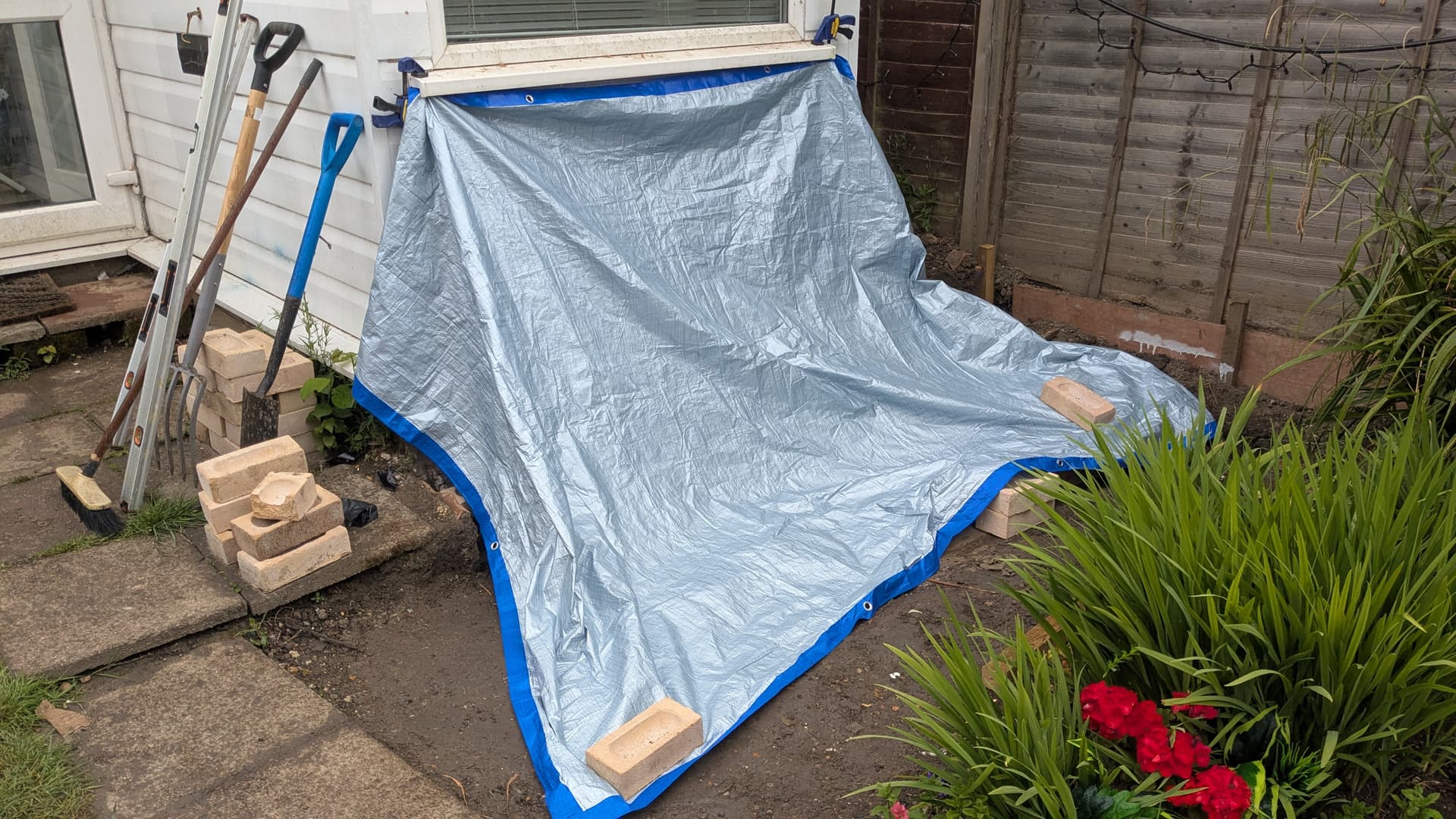

No rain today, so prep again
ta daaa

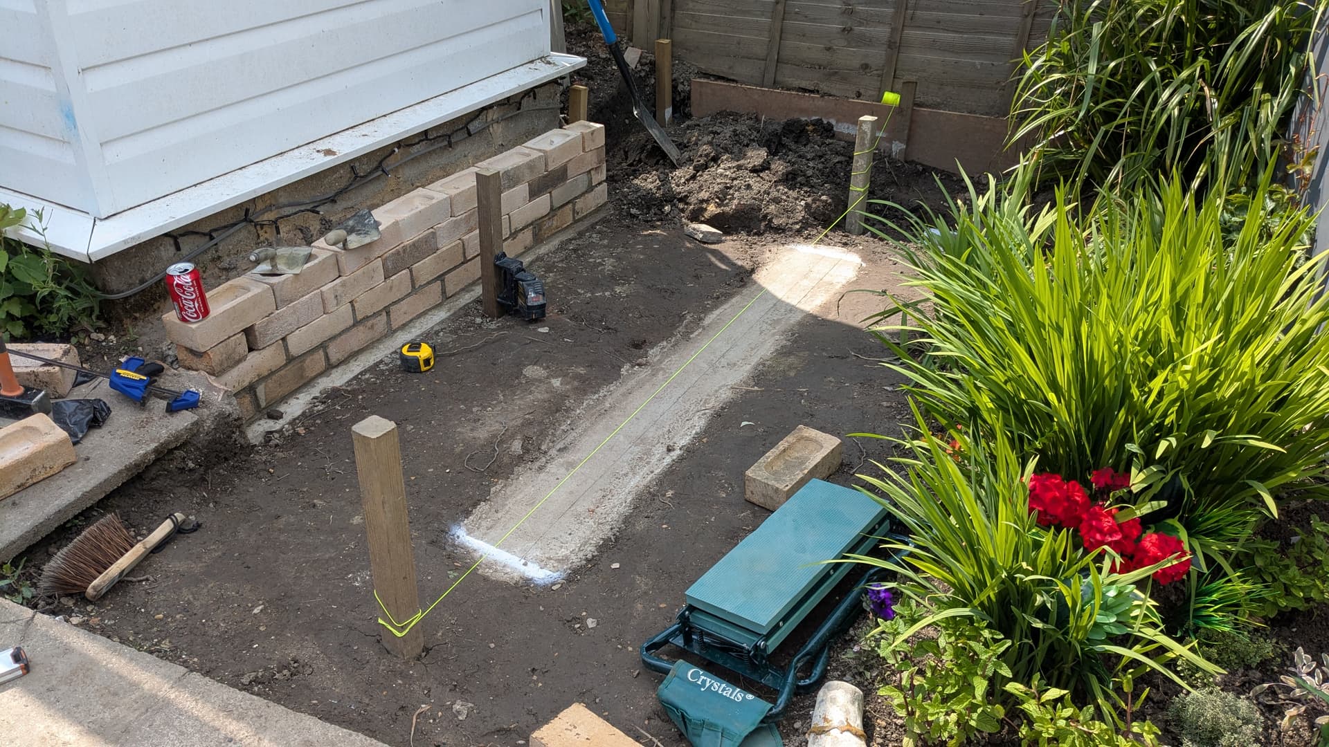

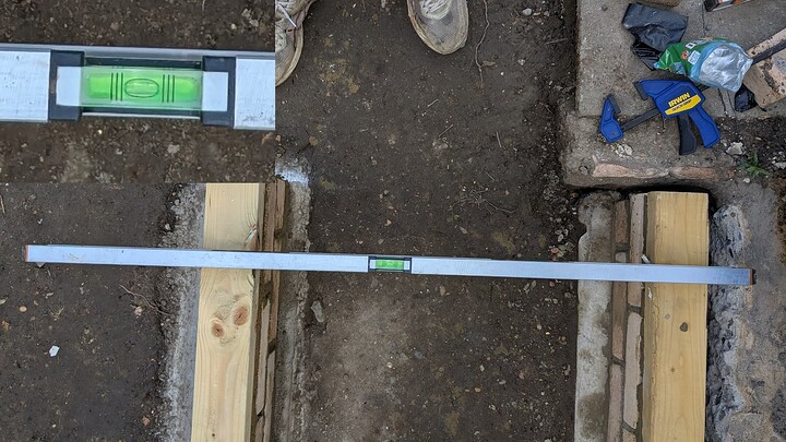

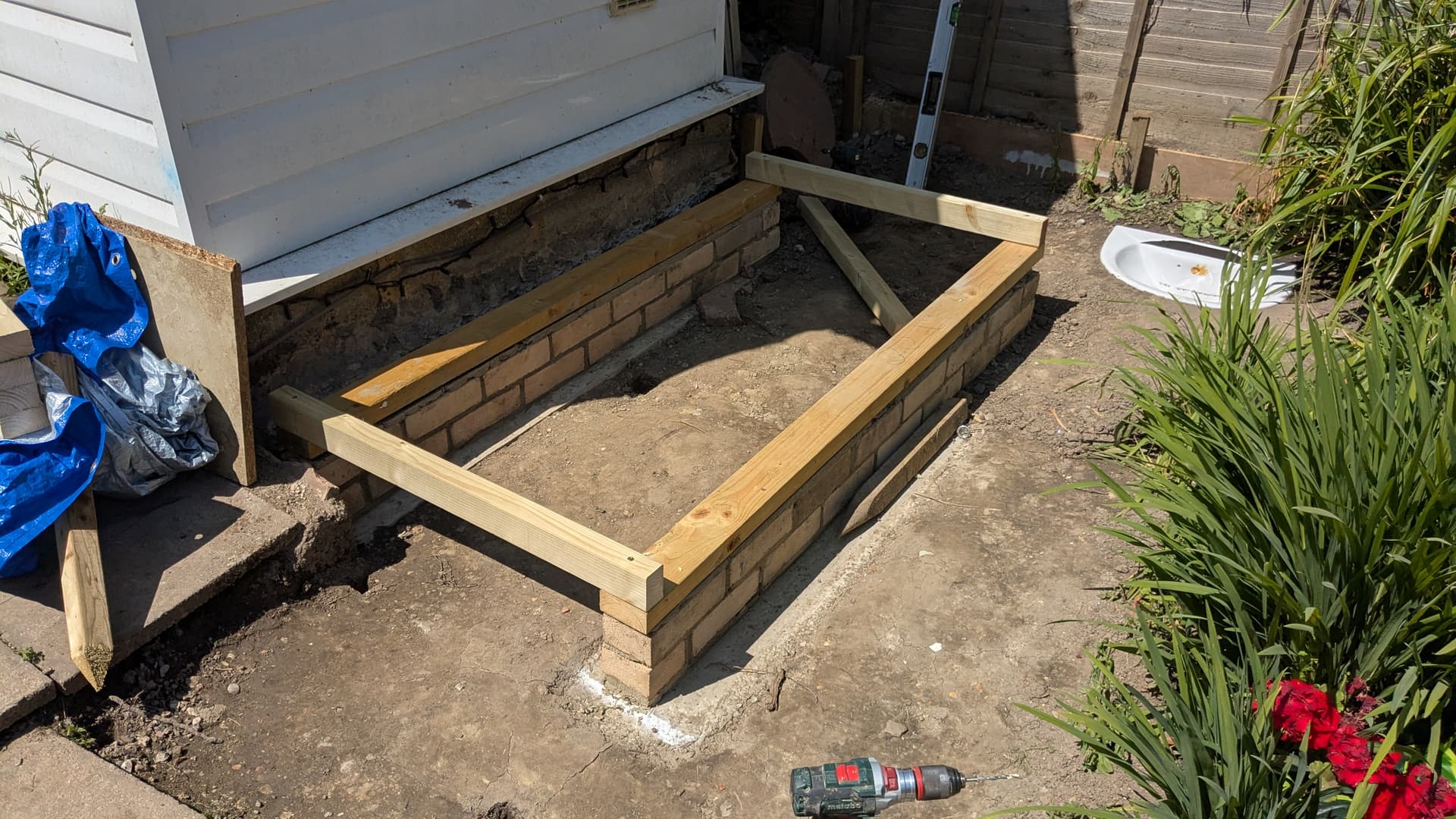

put wall plates on…questioning way, as usually their purpose is to give a tie down and make a flat plane for a roof. Also, the timber was a bit bent :roll_eyes: Cleaned up though
Ahhh they’re close enough, if the occupant complains that marbles are rolling around, I’ll pack it :slight_smile:

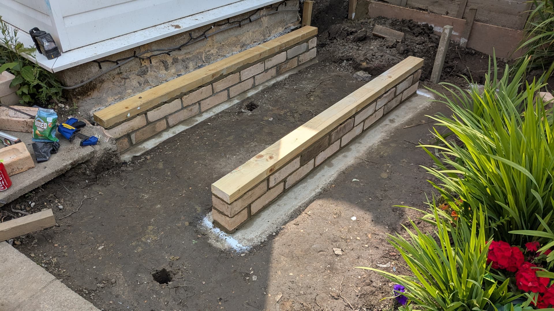

tidied and cleaned up, next job will be timber work starting with floor joists…be strange to start with the roof!

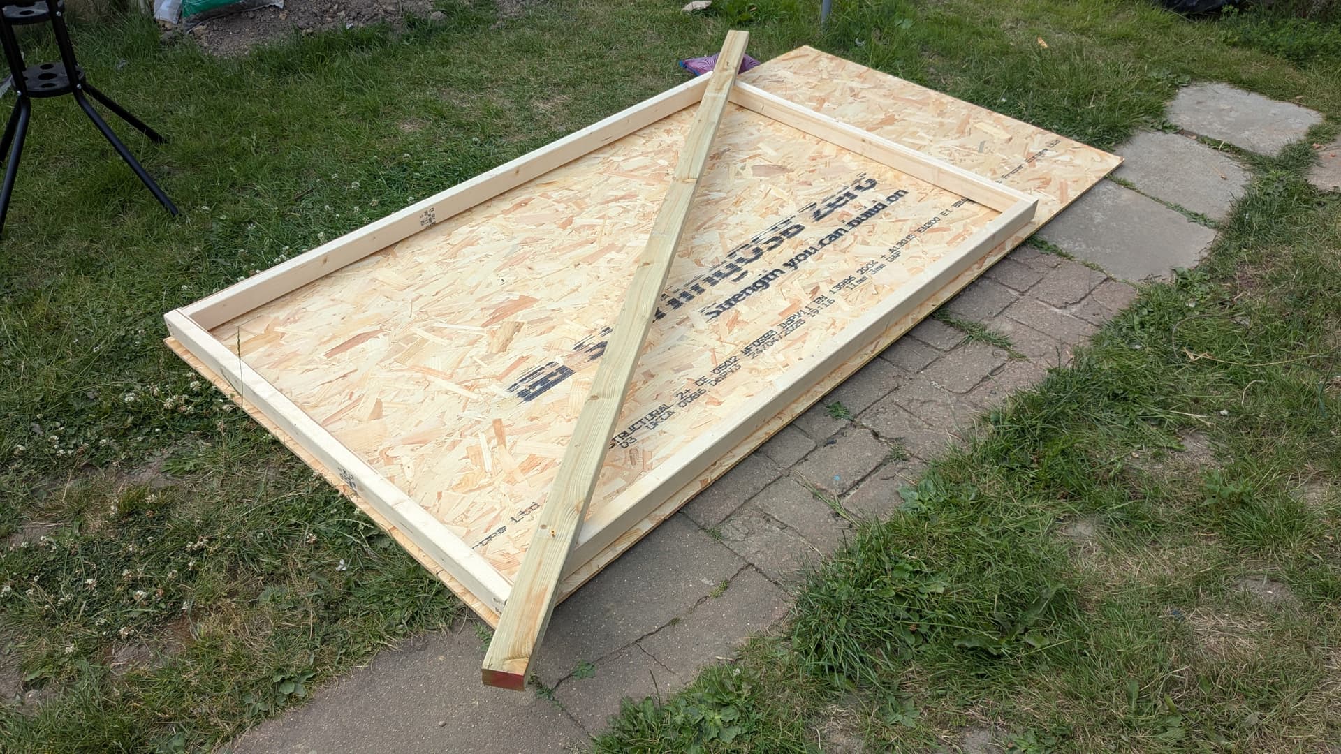

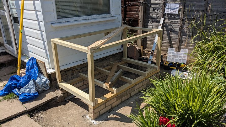

making the top wall plate

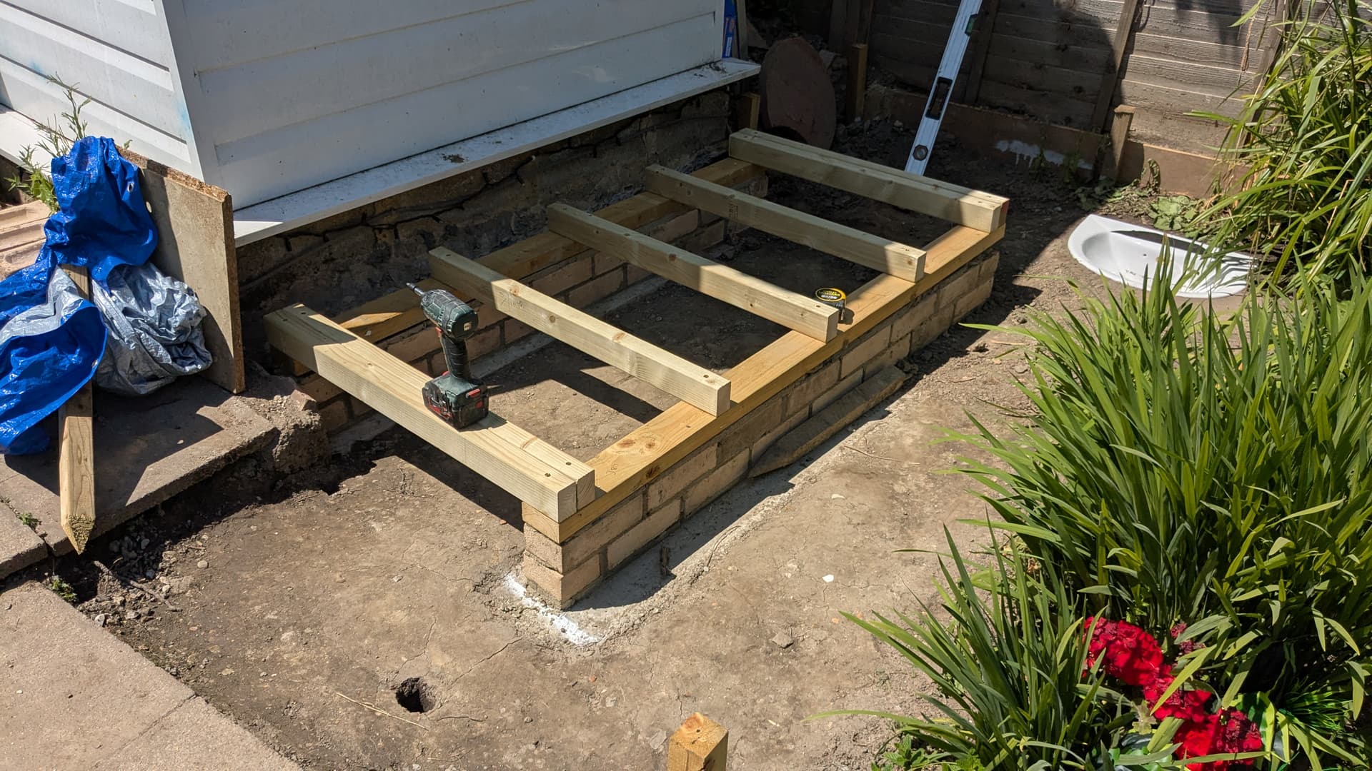

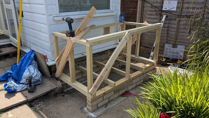

starting on the joists

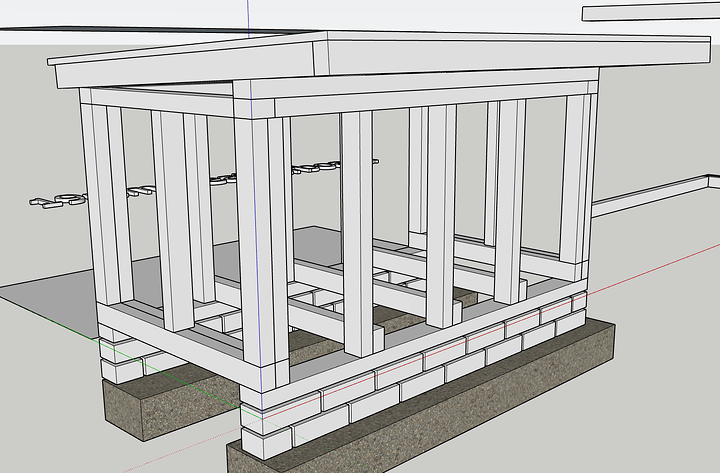

design has changed a bit, not much

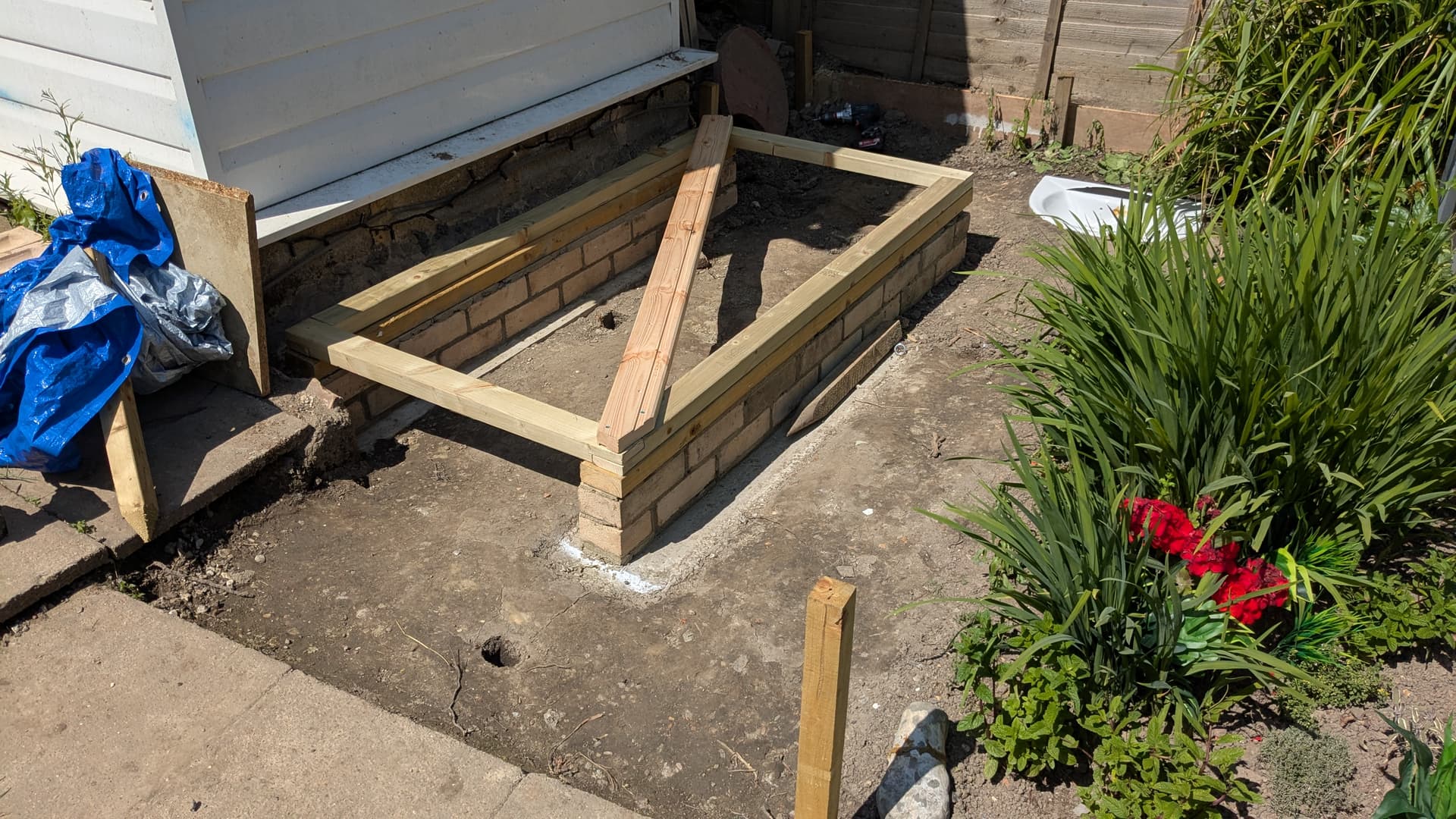

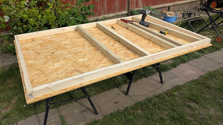

teeny tiny floor joists on, quite funny that my brain is in building autopilot and make sure they were less than 400 centres (just under 16") :laughing:
and test fit of wall plate

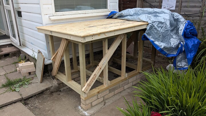

“apparently” tortoises need a certain height and just so they stay warm, they’ll be two floors, with a hope that the top floor will be warmest and have fancy bulbs (busking or something).

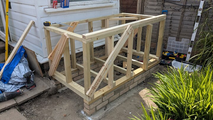

slow progress, but I’m having to think about stuff!
starting on the roof next

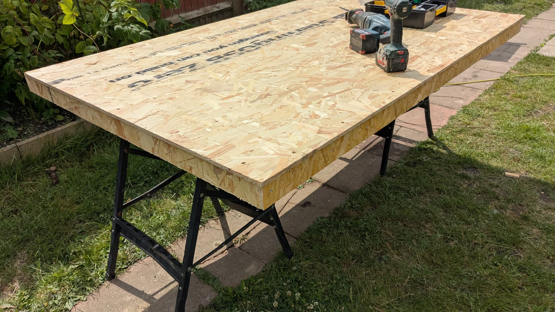

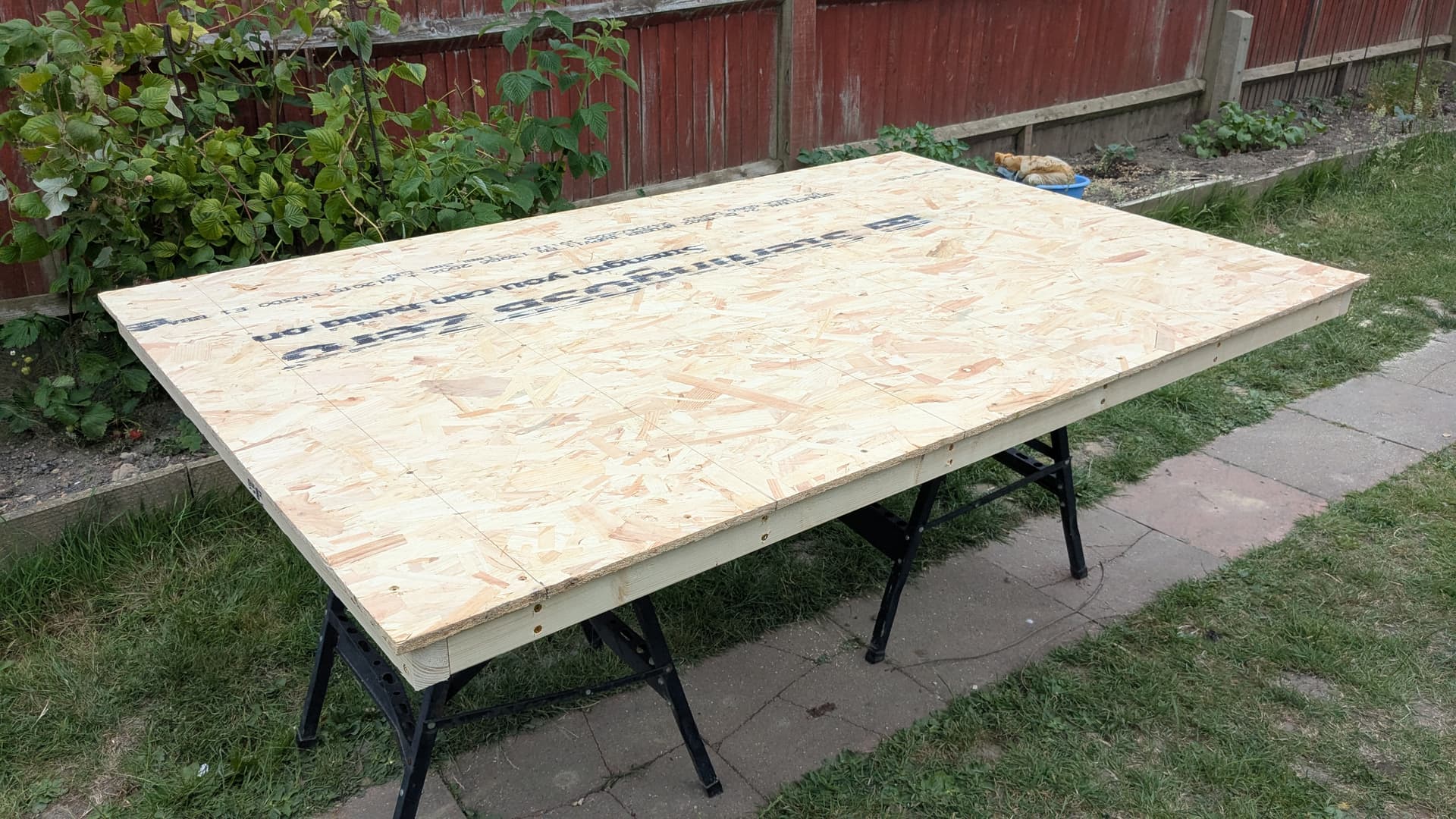

Making the roof
and the roof is on (for now)

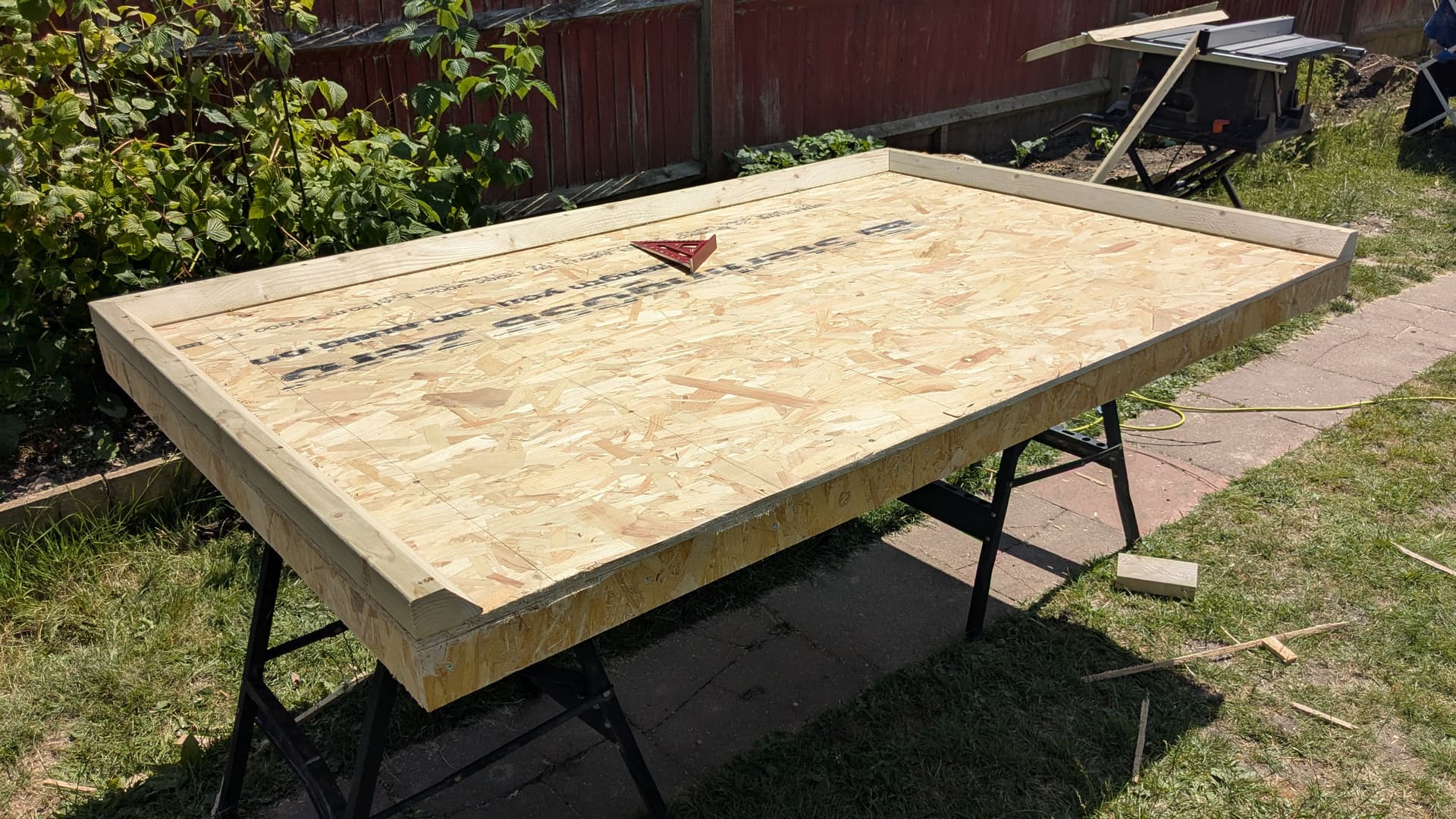

back to the roof today, putting the side packing on
put the edging on (nearest face is where water comes off)

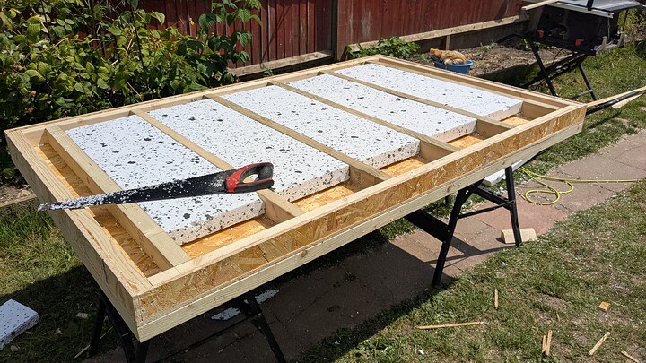

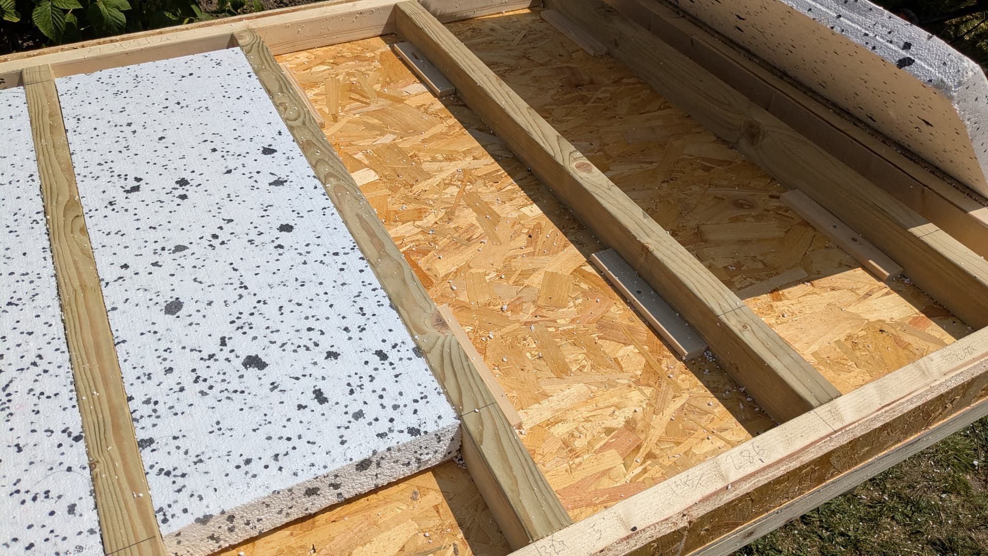

packing for insulation, to leave a little air gap to prevent rot
insulation to roof done

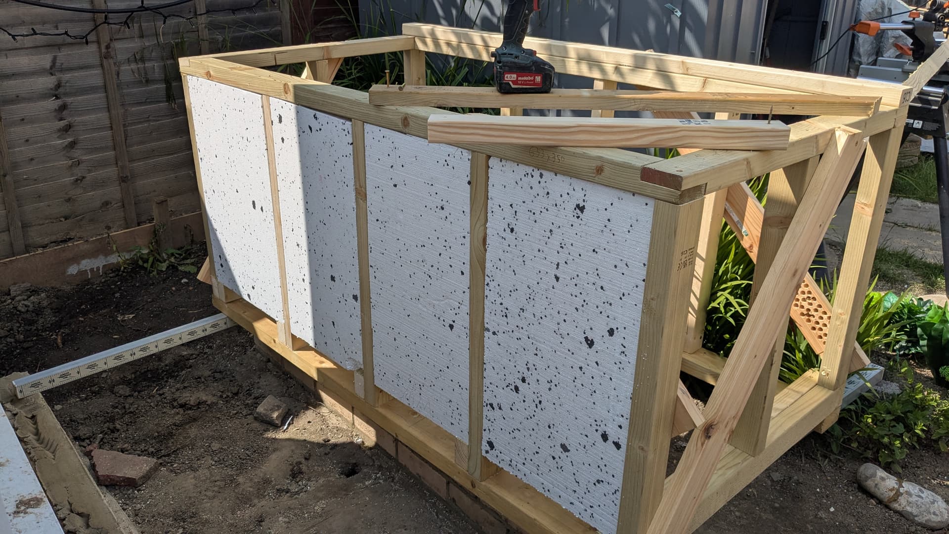

rear side wall insulation fitting

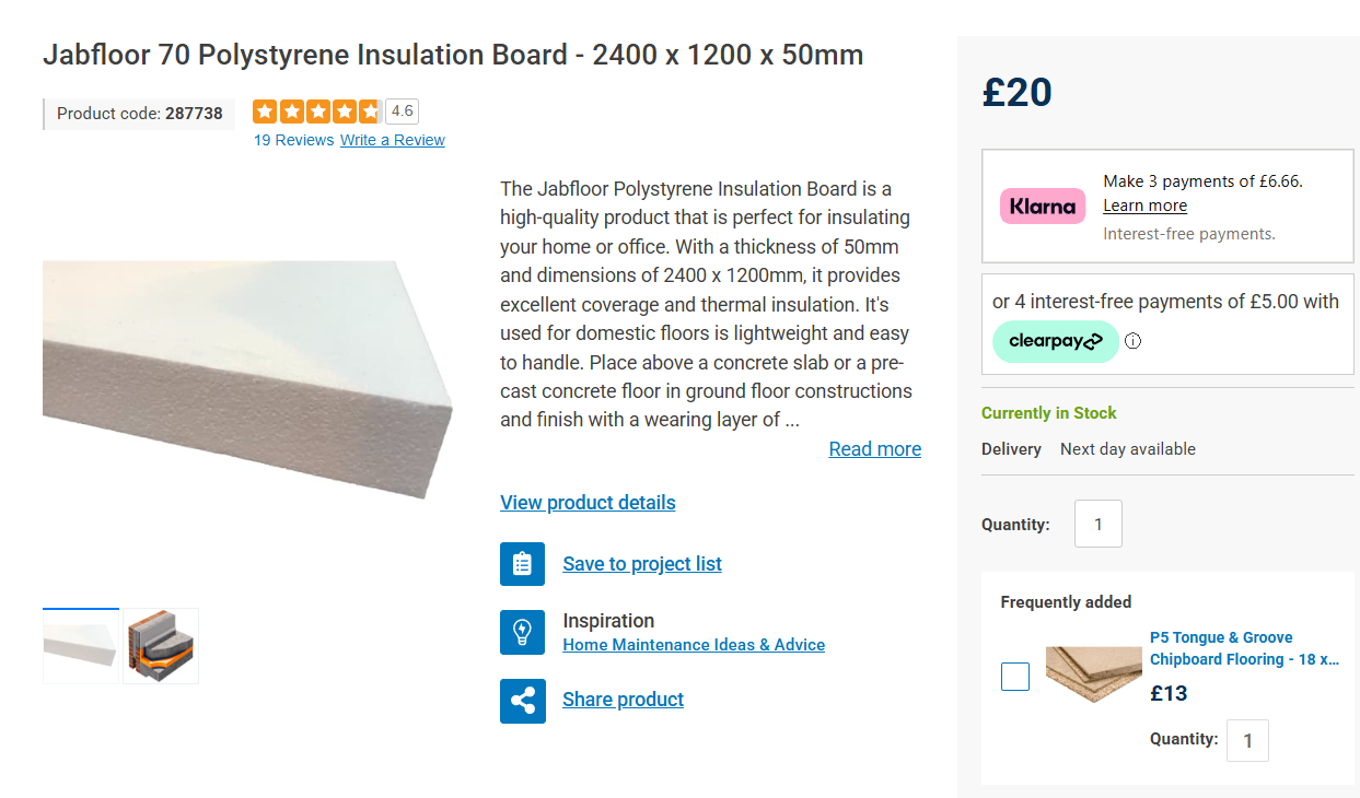

What type of insulation is that? I assume you guys use R value over there?
From my little knowledge I assume it’s polystyrene EPS or something in that area.
The version with black inserts is probably the regular white version, only produced after the graphite version and contains a small amount of residue from earlier productions.
Some manufacturers(Jablite…) apparently use this as a distinguishing mark.
Thats what I was guessing, but think most of ours in the US is just a solid color so was wondering what was up with the formula
I don’t see from the documentation that they used anything special for these spots. So the legend of intentional coloring may be true, although I wouldn’t bet my head on it. :slight_smile:
Dotted Styrofoam is created by combining white and graphite Styrofoam. The white part of the Styrofoam contains characteristic dark dots of graphite Styrofoam, which is one of the most valuable insulation materials on the market. The production process of Dalmatian Styrofoam is quite simple. Graphite Styrofoam balls are introduced just before the production of white Styrofoam boards and are a remnant of the production of graphite Styrofoam.
Sounds like AI so who knows…

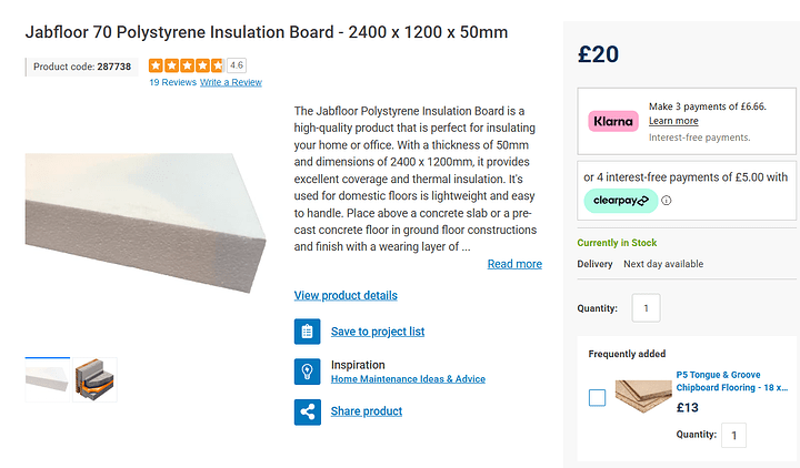

@TimHolus is right, here’s the stuff:
I got this because it’s basically cheaper :slight_smile:
We do indeed, though they’re just called “U-Values” over here.
Buildings here need walls and floors to have a U Value of 0.18 W/m²K (Watts per square meter per Kelvin). Roofs need 0.15.
It’s a real pain to achieve this and sometimes with roofs, we actually propose thicker rafters to accommodate it, rather than having slithers of rigid insulation to the underside, which is a hassle to install.
It wasn’t as extreme as this until 2022, for example before this we could have 100mm brick, 100mm cavity (part or full fill with rockwool batts) and 100mm blockwork internal leaf. Now we need 150mm cavities with specific cavity fill, reducing room sizes and of course making the cost go up slightly.
What I’ve done is going to make a difference, but it’s no where near the regs for a real house, as that would make the walls a minimum of a foot thick! :roll_eyes:
