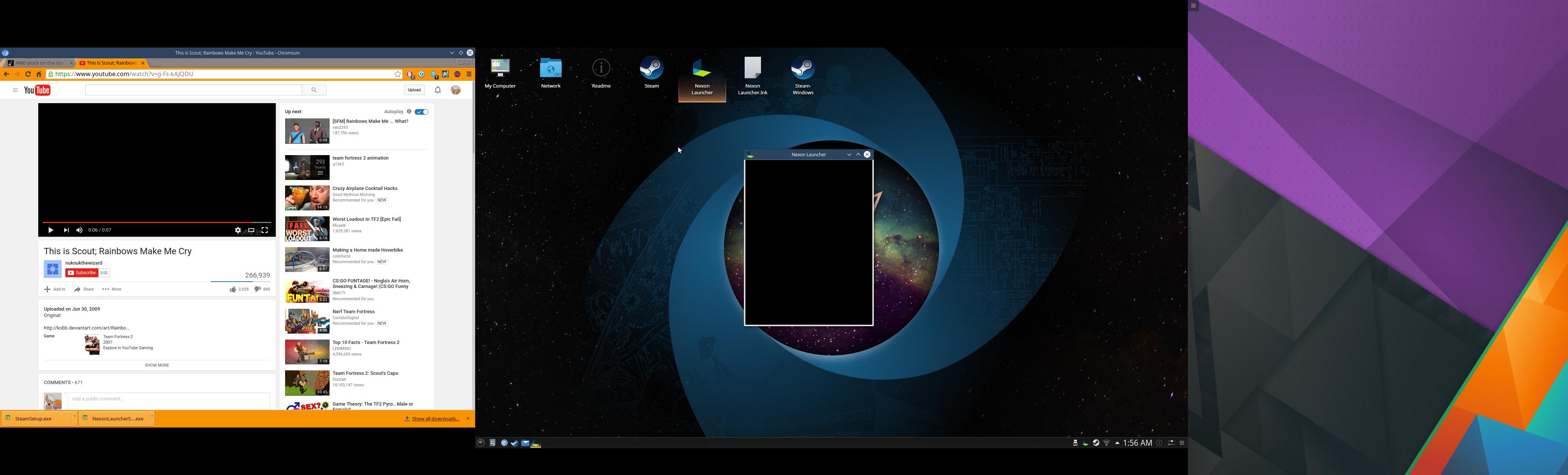

Need some help. I'm trying to work on a wineDB entry that I don't think anyone else really cares for all too much but I can't see the window, its all black :U
There a reason for this?
