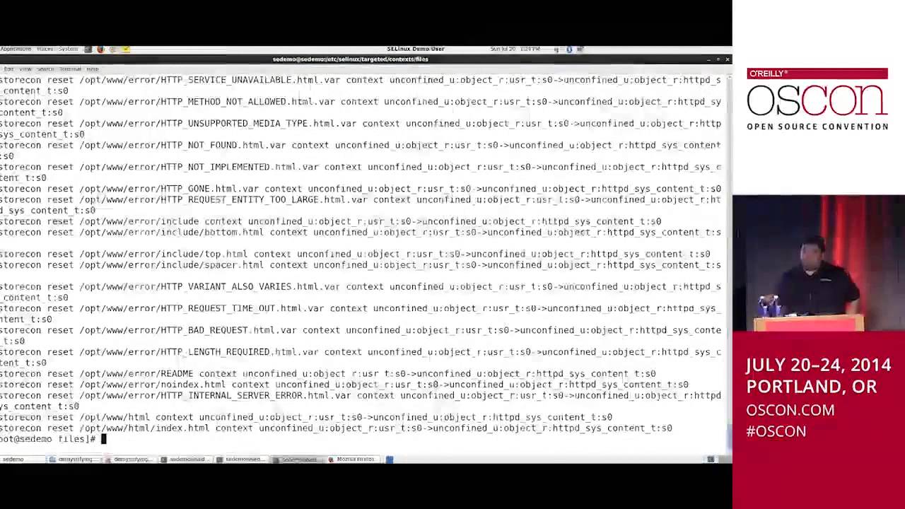

Most likely the security context of the files was incorrect.
-# restorecon -Rv /var
restorecon changes the labels/context of the files to what SELinux expects them to be based on the directory they’re in.
So i.e. web server stuff should run in the httpd_t type domain, and the files should be labeled as httpd_content_t iirc.
And then there’s a bunch of booleans as well that might be interfering https://dwalsh.fedorapeople.org/SELinux/httpd_selinux.html
Also, sealert is your friend.

ISPConfig 3.1 + SELinux…
seriously? This is still a problem? I remember sorting this out for 3.0. Cleaning up some mail servers aaaaaaand its this BS again.
SELinux, you are about to get secure-booted…
(FYI, I usually just sort out the alerts and enable as needed, but debugging errors that result in “nothing to do” when I perform the requested action is more than I have the patience for right now)
Care to share?
-# ausearch -c ispconfig
-# audit2allow -b
Or for a quickie:
-# audit2allow -bw | grep ispconfig
Still sorting through some obvious stuff that can be fixed… Once that’s done, I’ll try again and see if I am still getting errors or misbehavior.
#!!! The file ‘/var/www/ispconfig’ is mislabeled on your system.
#!!! Fix with $ restorecon -R -v /var/www/ispconfig
That context restore was successful. So, on to the next…
This is after I have done:
setsebool -P httpd_can_network_connect_db 1
setsebool -P httpd_can_network_memcache 1
setsebool -P httpd_unified 1
semanage fcontext -a -t httpd_log_t "/var/log/ispconfig/httpd(/.)?"
restorecon -R -v /var/log/ispconfig/httpd(/.
audit2allow -bw:
type=AVC msg=audit(1523981224.930:203): avc: denied { write } for pid=2052 comm=“php-cgi” name=“temp” dev=“dm-0” ino=1000435 scontext=system_u:system_r:httpd_sys_script_t:s0 tcontext=unconfined_u:object_r:usr_t:s0 tclass=dir
Was caused by:
Missing type enforcement (TE) allow rule.
            You can use audit2allow to generate a loadable module to allow this access.
type=AVC msg=audit(1523981224.934:204): avc: denied { remove_name } for pid=1419 comm=766C6F676765722028616363657373 name=“access.log” dev=“dm-0” ino=1002491 scontext=system_u:system_r:httpd_t:s0 tcontext=system_u:object_r:httpd_log_t:s0 tclass=dir
Was caused by:
hmmmm, no paths there???
Yeah that’s a bit weird, haven’t encountered that before, or never notice at least. Anywho you could allow those actions using the pid as an identifier to create custom modules.
-# ausearch -p 2052 --raw | audit2allow -M my-ispconfig-php-cgi-thingy
-# ausearch -p 1419 --raw | audit2allow -M my-ispconfig-log-thingy
To give httpd_sys_script_t:s0 write perms on usr_t:s0 objects ( that usr_t could be a hint on the path )
And to allow processes in the httpd_t:s0 domain to modify httpd_log_t:s0 objects ( Shouldn’t that be allowed by default? What kind of action exactly is ‘remove_name’ btw? )

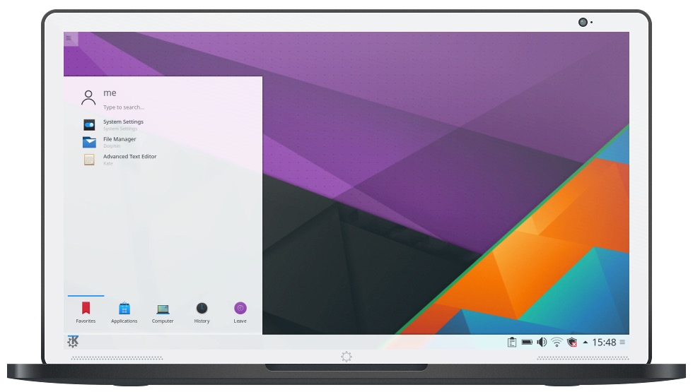

I’ve got a bit of a silly problem, really small but annoying to figure out if you don’t know how to undo it. :slight_smile:
I recently installed the currently most recent version of Kubuntu and I accidentally put the ‘start menu’ (Simple Menu Launcher?) on fullscreen. This happened when I was configuring a global keyboard shortcut to maximize windows to fullscreen. Maybe the Simple Menu Launcher went to fullscreen because of that? How do I get it back to a small window like on the picture here?
Edit

Another edit.
I found a solution. alt + right mouse button and you can grab the window of the Application Launcher. I can now confirm that it was done by maximizing the window, I did it again, this time to try it out. Is that a bug? Something which the developer overlooked? It seems to me like the size of that window should be locked.
