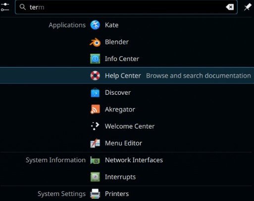

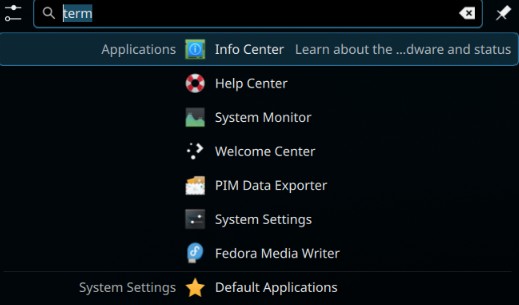

More troubles with KDE…
Is there a way to make krunner learn, or at least manually make it prioritize search results?
I can’t imagine most people are looking for Kate or Blender when they type “Ter” in the search box.
There are some articles out there describing how to add keywords to .desktop files, but all those keywords are already there.
Some suggest disabling search categories, but that won’t help either - it buries Konsole under every other app.
Screenshot_20251107_094428
Notice it tries to be helpful and allows me to tab to auto complete but that is somehow even worse.
Screenshot_20251107_094545
There is something weird going on here, on my system Terminal is the first result with “ter” typed in.
On yours Terminal doesn’t even seem to show up at all.
Are you using the default one, Konsole?
