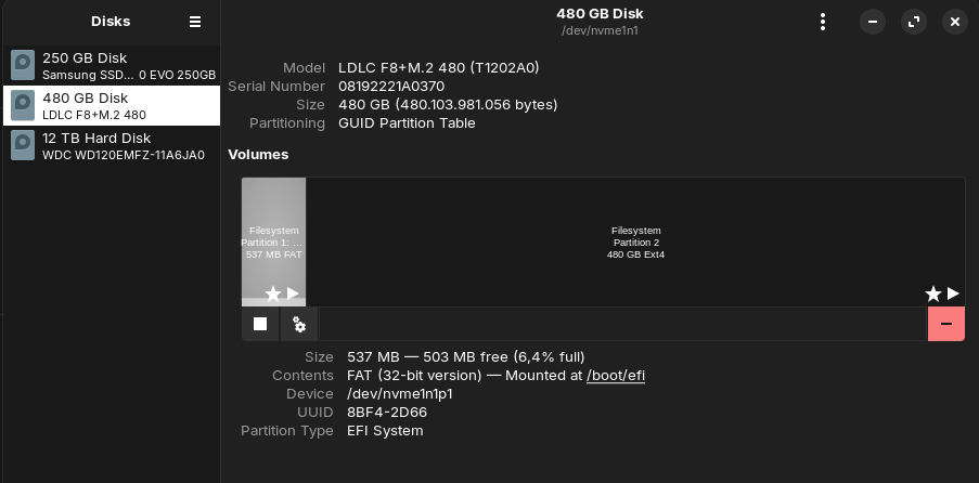

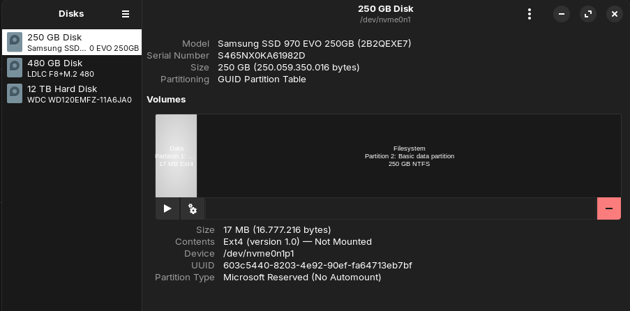

Hi there! I’m currently using 2 SSD’s in my ZorinOS installation. One 256GB one which I installed ZorinOS to (nvme0n1), and a second Windows 10 Pro 512GB one (nvme1n1).
I thought my bootloader was installed into the ZorinOS one, but as soon as I removed the W10 one to give it another purpose, it wouldn’t boot into Linux anymore. This is weird since I especifically installed each operative system in a different physical drive, but I guess Windows, which got installed afterwards, is predatory enough to have taken the bootloader partition somehow.
This is how it currently looks in Disks:

Probably the boot sector didn’t get installed on that drive because there was already a drive in there flagged for it. So you would have to carve out a boot sector, I guess - I don’t know any other tricks, but I’ve not had to deal with many problems on this front.
https://wiki.archlinux.org/title/EFI_system_partition
edit: except it looks like the 256gb disk has windows, and the 512 has linux? and the boot sector is on the 512?
My bad, that is right, it was the other way around. I’m so dumb.
I’ll read the documentation, I will need to figure all this out once I upgrade from the 512GB SSD anyways, but that’s a story for another day.
My god, I can’t believe I Just spent the whole afternoon trying to troubleshoot this. I originally removed the 512GB SSD and left the 256GB in, so I guess Windows couldn’t boot because the 512GB (Linux drive) had the boot sector on it.
