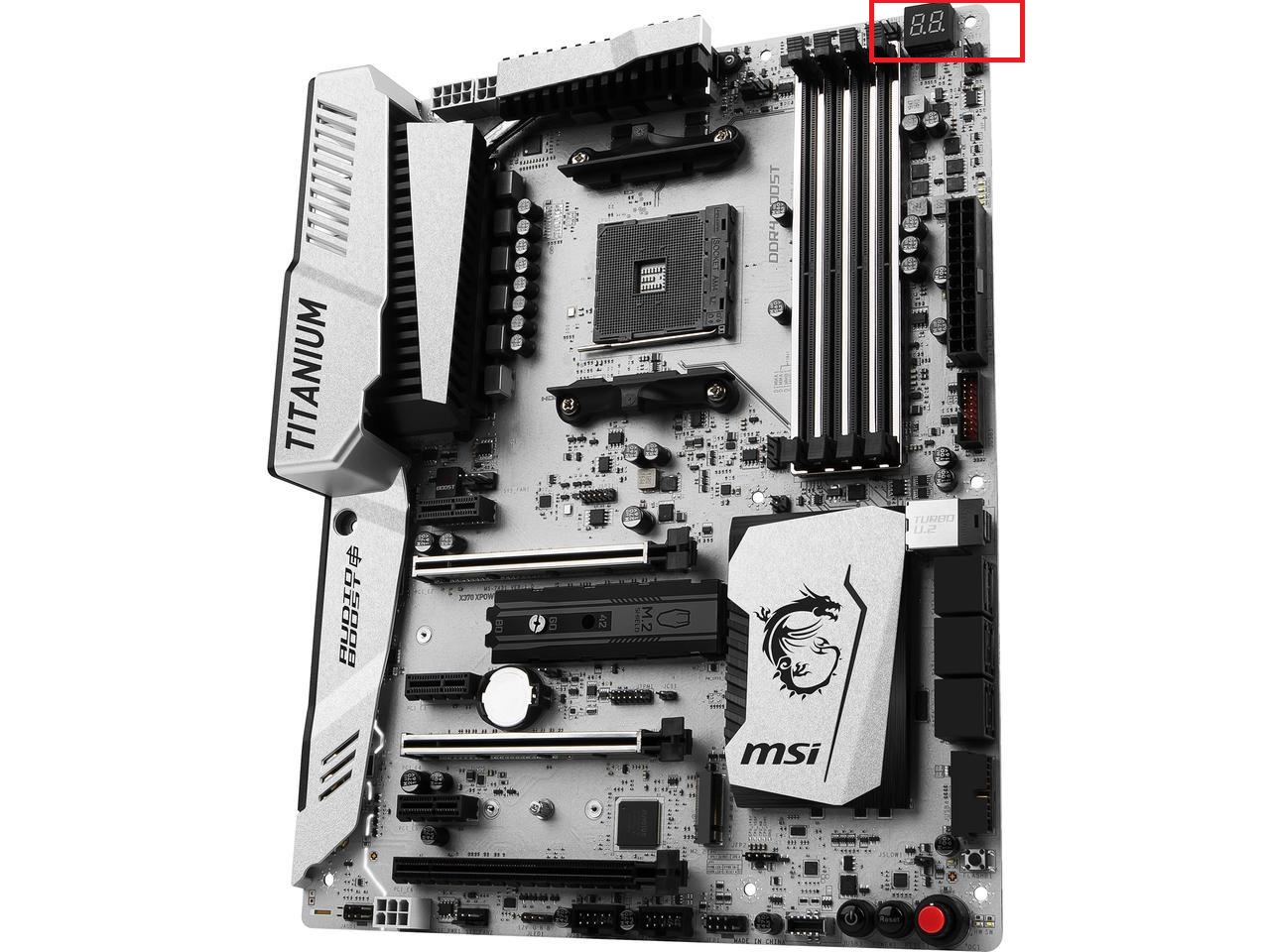

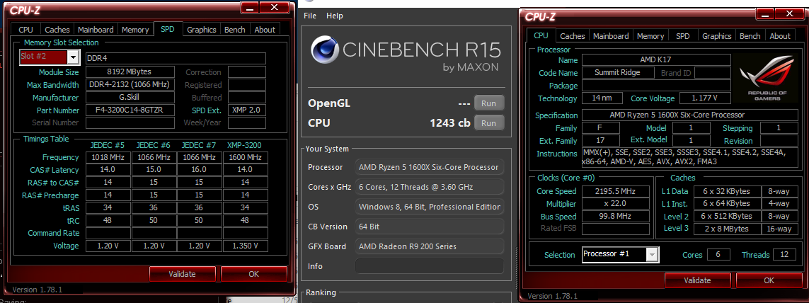

Why 22x 99.8MHz?
99.8MHz "bus clock" seems to be the default for this platform, and only motherboards with a separate clock generator could run differently.
Errr. No.... That's for the BIOS Hex Code output. Also goes by the name of "Dr. Debug". Complementary to BIOS Beep codes when an error happens.
Clock generators are a different thing entirely. There a realtime clock generators that keep track of time and date, there are clock generators that define the base reference clocks (frequencies) for the CPU and RAM buses.
I was just wondering what it was, because only the expensive ones like Crosshair VI have it. I thought the expensive ones had external clock generators.
I feel stupid as that was my first guess. My second guess was the external clock generator.
External clock generators are useful for extreme overclocking because you can use the boards reference bus clock instead of the internal CPU clock generator. There are many complicated electronic engineering concepts associated with it. But the main reason for external clock generators are thermal stability. Clock generators often need to be kept at a nice constant temperature to remain the most stable.
Being outside the CPU is useful for extreme overclocking (think liquid nitrogen) where cooling the reference clock generator down too much would cause it to run out of spec.
It's also has many other benefits, mainly associated with overclocking. It's safe to say though that you won't really need one if you confused the debug display with an external reference clock generator
Well as I added the clock generator was my second guess. I know I dont need it, but it was just something I asked someone in teamspeak and they apparently were trolling me. Like I said I feel stupid because two days ago I new exactly what that is. Now I trust a trolling friend that trolls me all the time.
Anyways I could make use of it because it would be nice to see error codes, but my motherboard being a cheaper x370 lacks it.
