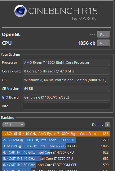

Managed to push my chip to a safe limit
Absolutly stoked.
Won't run this 24/7. Will change it to P state overclock down the track and waiting for a better bios but for now, This is one of the best chips I have seen. Seen one person hit over 1900 at 4.1 with 3200 memory, slightly different timings but jesus ryzen is powerful
