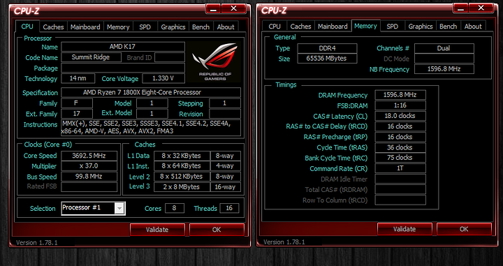

I have 4x 16GB sticks of GSkill Trident Z 3600MHz memory running at 3200MHz with timings 18-16-16-36 CR1
Chose those timings to give headroom, haven't tried tighter timings but it works.
Got it working first try as well so with good memory/cpu/motherboard, 3200MHz with 4 dims of dual rank memory is very much possible
What board is that?
Crosshair VI Hero
