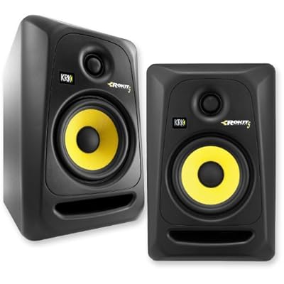

I definitely recommend the Rokit speakers that @roasthawkmoon recommended above. They are fantastic first monitors to get.

Yeah, if the OP is still around I'd also recommend those KRK Rokit 5's.
They're nice monitors and should serve you well.

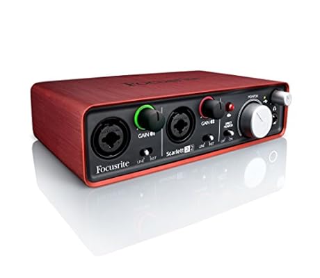

I would buy a nice external audio interface to go along with them as well, one of the reason being just like what Prague mentioned.
Computers are noisy (electrically) and if you plug these studio monitors to your computer RCA <> 3.5mm, you'd have issues. And if you'd have these studio monitors AND the computer power cables plugged into the same circuit (grounded), you'd face an annoying ground loop. Basically a hum. Which can be a pain to get rid of.
Getting an external (USB for example) audio interface (fancy name for a sound card) with balanced output (1/4" TRS or XLR) and using balanced cables between your monitors and the audio interface can solve that issue.
Funny thing is that in some extreme situations you could have a ground loop hum even if you'd have balanced cables between the monitors and the sound card. Which can be infuriating :D
Other people can probably chime in on good choices for audio interfaces but I'll throw this here
Another benefit of buying a studio audio interface is the microphone input (XLR) and they usually have 48V phantom power so if in the future you want to get yourself a fancy studio microphone for whatever reason, well, there you go.
There are cheaper alternatives out there also but I don't know much about them so hopefully others will chime in.
