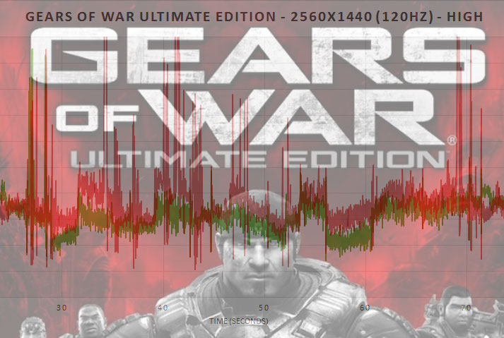

PCper did some testing last year comparing FRAPS and PresentMon. The latter had more consistent result closer to the FCAT data IIRC. I'll dig up the link to the article... there:
https://www.pcper.com/reviews/Graphics-Cards/PresentMon-Frame-Time-Performance-Data-DX12-UWP-Games
Relevant graph:
This was done more than a year ago though, PresentMon released their 1.0 version just a week ago or so.
