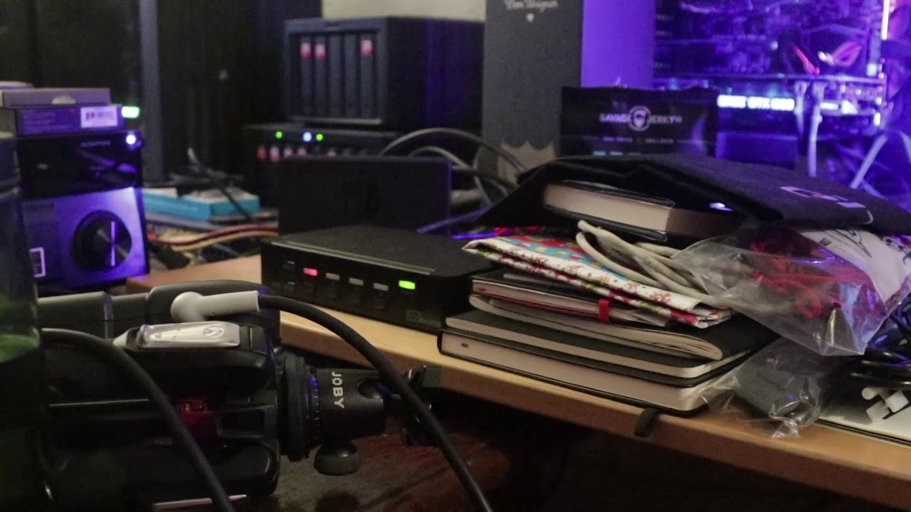

Hi All - I can confirm 100Hz for Gsync works on the single monitor KVM… and I made a video too
