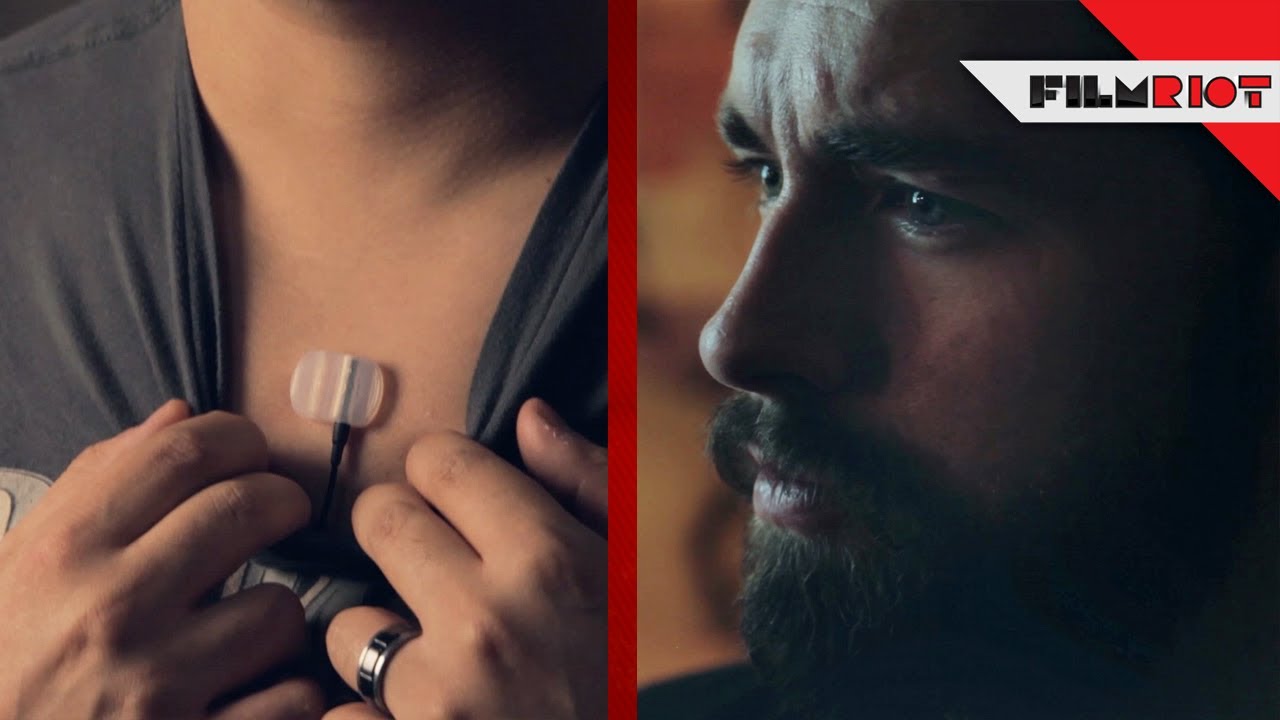

also I haven’t tried it personally but Invisilav looks like a useful tool. Here is a review/somethingoddinthebeginning
