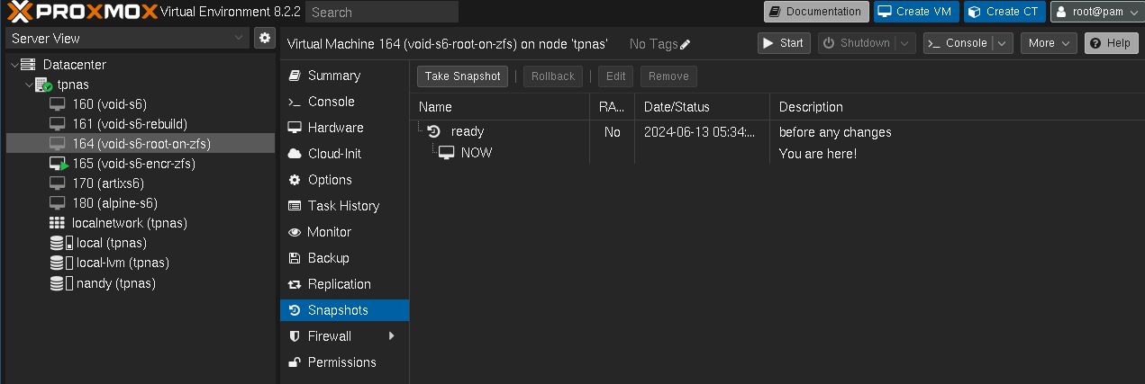

Have I complained before how much I hate proxmox? I probably did, people on the forum know I’m a hater and only begrudgingly recommend it to others (because there’s no real good, easy and libre alternatives and virt-manager seems to be a dying product too, just like a lot of red hat’s legacy).
You try to clone a VM from an existing ZFS snapshot, it tells you that a full clone is not supported and doesn’t give you the ability to make a linked clone (I don’t think that’s possible with the zfs backend anyway).
Here’s the snapshot. What’s so wrong about this?
So I took it in my own hands, literally zfs-send from vm-disk-164-0@ready and vm-disk-164-1@ready respectively, to new datasets, vm-disk-165-0 and vm-disk-165-1. Deleted the vm-disk-165-{0,1}@ready snapshots and was left with perfectly usable datasets.
Created an empty template, similar to 164, looked at /etc/pve/qemu-server/164.conf and added the efidisk0 and virtio0 to 165.conf, changed the boot order and was left with a perfectly working VM 165 in the screenshot (formatting and installing root on encrypted zfs).
Proxmox, how hard can this be? I literally did it in 7 commands, maybe 8 or 9 if you count clicking the snapshot button in the GUI.
