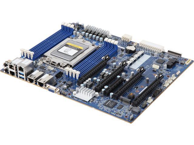

Really nice build! I’m curious to know more about the AMD CBS settings seeing as Gigabyte barely explains any of that in the manual. E.g. how does the determinism slider affect performance? Is there something else that could squeeze out the last drop?
Just to add to the discussion, I’ve built a very similar system to use as a fat node in a cluster for physics simulations. I used the same processor and chassis, but with the Gigabyte MZ31-AR0 EATX motherboard, 512 GB 2666 MHz RAM (16x32GB) and used a Noctua NH-U14S heat sink with a Noctua 3000RPM iPPC fan. The other nodes are almost identical except based on the Threadripper 2990WX using 128 GB RAM. There were some minor hiccups:
  • The memory runs at 2133 MHz when all 16 slots are fully populated. To my knowledge there’s not much I can do about this. Is it the same for the MZ01-CE0? It has some frequency settings I’ve not seen on mine.
  • The EATX motherboard doesn’t really fit in the R6 ATX chassis; there was a labeling mistake at our suppliers, so I had to get creative:
    • The heat sink collides with the hard drive mounts, so I had to remove the mounts, panel and supporting beam that holds all the drives completely.
    • The mobo is wider than the back plate (EATX > ATX) only half of it is supported by the mounting screws, the rest hangs in the air. Luckily I found some cotton furniture pads to squeeze in between the mobo and back plate, so the area under the CPU and DIMMs gets proper support.
It worked nicely in the end and it’s up and running. A really good performer too, and seems to suffer less than the threadrippers from memory demanding work loads with high thread count, presumably due to the additional memory bandwidth/channels. I’m really eager to get back to work and explore the bios some more… or perhaps I should just use IPMI :smiley:
In any case, love to see Epyc content :slight_smile:
I only have a total of 8 slots but 3200 worked just fine on all 8 slots
I’m curious, can one buy the Gigabyte MZ01-CE0 online anywhere? Or is it necessary to call one of Gigabyte’s distributors and get a quote? If you’re allowed, I also wouldn’t mind knowing the general ballpark price I should expect to pay for the MZ01-CE0. Thanks for any help you can provide.

Great video. I’m researching a build for 2019 to replace an FX-8350 cloud host (I need that management port). I have some questions:
  1. Have you run any Windows 7 VM’s yet on the Epyc platform? How is the performance? Any issues? Does it feel like the power of the Epyc is showing on the Windows 7 VM?
  2. What power supply did you choose for that motherboard? It requires 2 8-pin 12-volt connections, I’ve not found a redundant server power supply that seems to have two of them.
First post on the forum … Hello!
Followed Level1 on YT for a while. Seeing this build has motivated me into building an EPYC system.
(that and getting a stunning deal on a 7401P…)
So, finding SP3 boards in the UK has proven to be difficult, however I seem to have found a supplier that can sell me a Gigabyte MZ01-CE1 (ATX, no 10GBe).
I planned 8 (new) sticks of 8GB 2400 mhz DDR4 ECC to make 64GB, fully populated.
For similar money I could go for 4 sticks of 2nd hand Samsung 32GB DDR4 2Rx4 PC4-2133P
It will become my replacement ESX 6.5 server where I run a number of Xubuntu virtual desktops.
  • Am I going to see much difference dropping from 2666/2400 to 2133?
  • How big a deal will it be to only populate 4 slots ?
My gut tells me twice the memory will outway the speed but I am really not sure about half populated vs fully populated…
Any advice gratefully received… :smiley:
Bump… Anyone got any advice EPYC memory config ?
