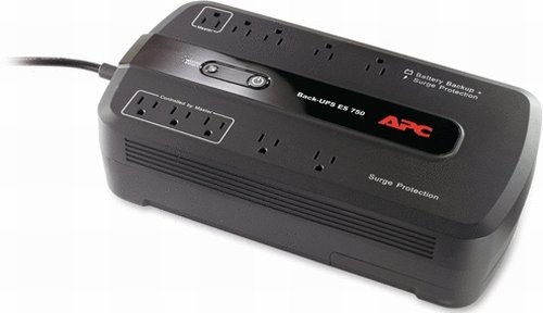

This is what I have, but I should have got a bigger one. $80
Side Note: UPS ratings are weird.
This unit is rated for 750 Volt Amps, which is not the same as Watts. I thought 'I have a 700W PSU, if I get the 750 UPS I am good'. NO! This UPS is good for about 450W but it is fine because I never use much higher than 400W.
Those little UPS systems are useless for anything except being dedicated for your cable modem and router. They have such little uptime capacity as to be a joke. Even at half capacity, which for these is like 150 watts, you are looking at like 2-5 minutes of uptime. They could probably keep your cable modem and router up for several hours. You could put your monitor on this one, and have a separate, larger one, for the computer, and that might be OK

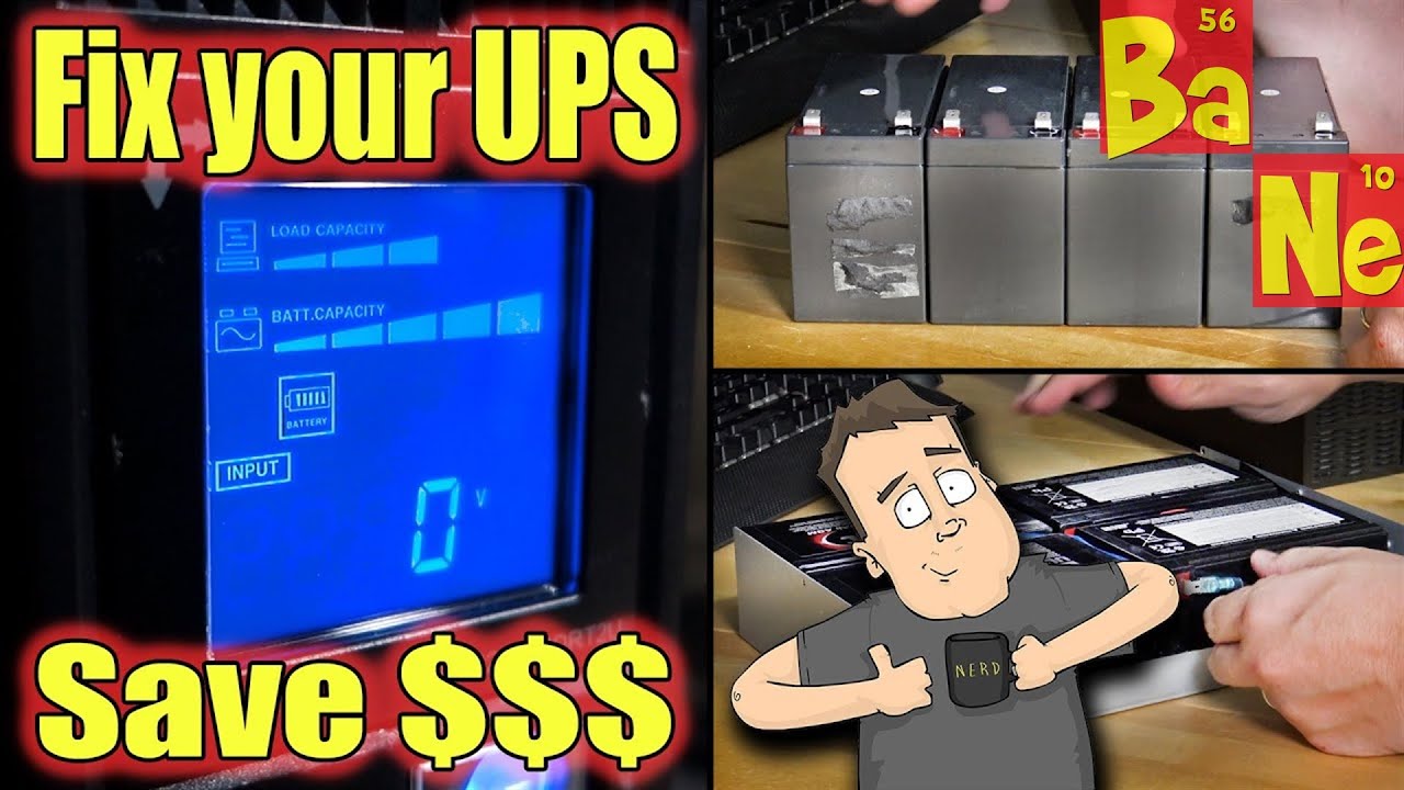

Try to get a used enterprise grade UPS cheap. You can often get ones with dead batteries for a couple hundered bucks. Then do what Jerry did, which is replace the batteries. You don't have to buy as expensive of batteries as he did.
Here's his video showing how he replaced the batteries.

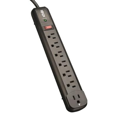

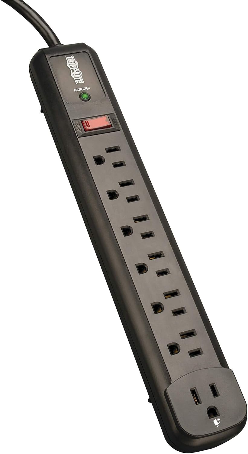

A pretty basic 'name brand' one should work fine, like this Tripp Lite unit. There's some BS $25,000 warranty on it that they will never pay in a million years, so don't get your hopes up.

i use this one here for my gaming pc, 2 monitors and a 3d printer no problems.
