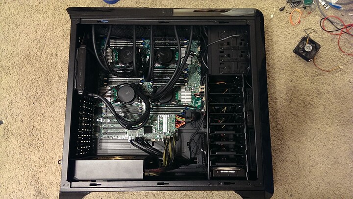

Another option, which I currently use, is the earlier Phanteks Enthoo 719 with an Asus Z10PE-D16 WS SSI-EEB motherboard. It has room for three large radiators, but the motherboard is right up against the PSU shroud, so if your motherboards are longer in that direction they won’t fit.

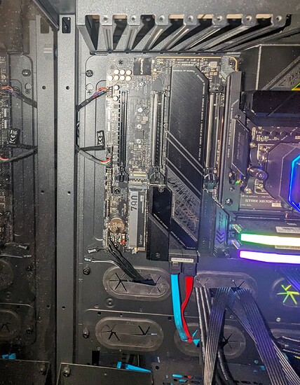

I believe you may be right — it probably would be a tight fit at best. I have an ATX board, 12" from left to right in the picture. The glass won’t be a problem — it comes with standoffs — but the vertical steel posts might not allow a much wider board
Not only there is not enough space between top edge, but also it looks like there is a recess going above the level of the PCB here. EE-ATX is out of the question.
Normal SSI-EEB should fit pretty well, though.
Thank you very much for posting photos!

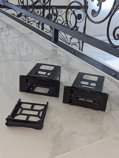

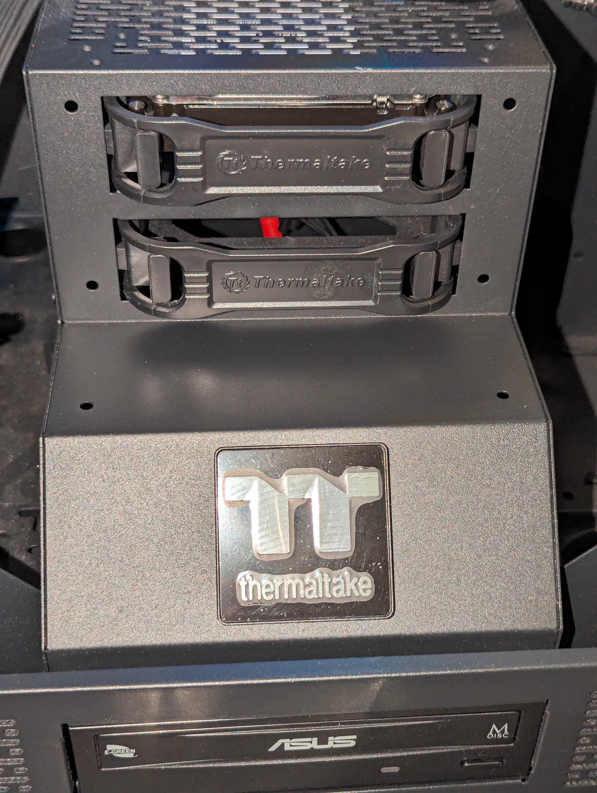

Oh, by the way, do you perhaps remember, how many hdd caddies were included out of the box?
I think it came with 6 drive trays/drawers. Two of them are in front. The other four were in two hdd cages in the back with two trays each. I easily removed the ones in the rear.
However, I also have a Snow Edition TT 900 which was less expensive at $229, and came without the rear cages.
